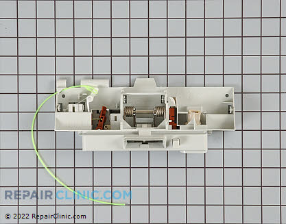

How to access the door latch assembly in a Maytag Neptune MAH5500BWW washer to replace it
Posted by Samurai Appliance Repair Man, in Washing Machine Repair 06 March 2012 · 1,172 views
maytag neptune MAH5500BWW washer door latch
First, come git you a new door latch assembly ==> http://www.repaircli...mber=MAH5500BWW
Then sing along with Doctor John..
Open the DETERGENT DISPENSER cover
Remove 4 phillips screws and pull out dispenser plastic assy
Standing in front of the washer---look at the front of the TOP COVER
There are (2) 5/16" screws that secure the top cover---through "L" shaped iron brackets. Remove both screws and the brackets.
Lift top cover
Source: Maytag MAH5500BWW accessing the door latch assembly to replace it
