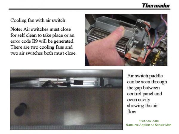

Thermador oven E9 error code / no self-clean complaint
Uploaded by Samurai Appliance Repair Man, Mar 25 2012 08:16 PM
Thermador E9 self-clean selfclean self clean air switch sail switch
