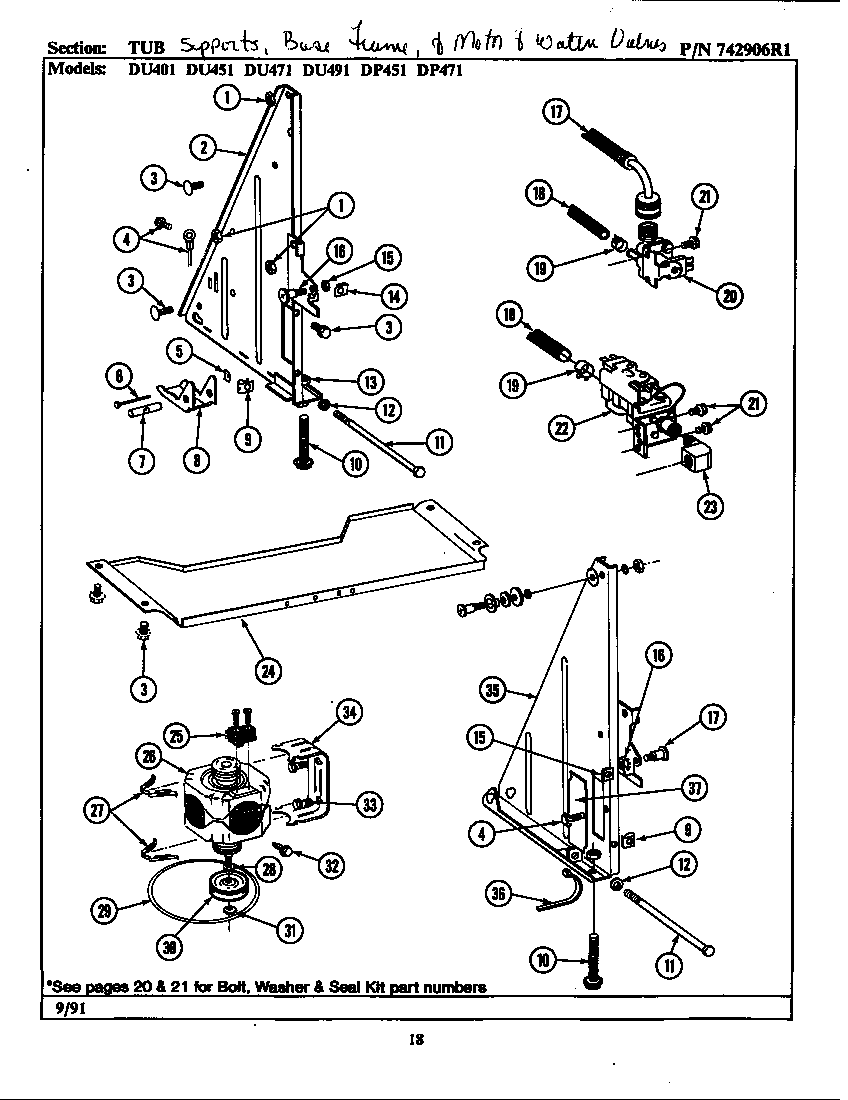

     Yes siree, Brother Reg.  If I remember correctly the model #'s started with WU or W.  Porcelain metal tub and a drive motor similar to the washer.  Pump assy was separate and pulley driven by a round, see-thru nylon belt that you had to lubricate with silicone after installed.  This unit was Maytag's answer to the Hobart made Kitchenaid dishwasher.  About the only parts I ever had to carry for this baby was the belt and the inlet valve (dual solenoid like the Kitchenaid valve).  Was actually still carrying those belts on the truck up to about 5 years ago.

Amp draw opperated soap cup, lack of water or clogged arms and cup would not open. Belt was a 9-2115 I think for the original number................... I'm getting teary eyed....
