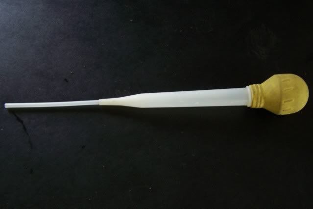

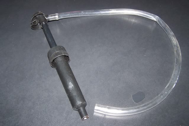

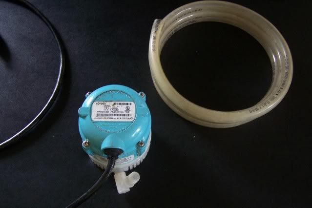

Just a few tools to drain the appliances to keep a mess to a minimum.. I found that it is easier to clean a small amount of water than a large amount.. A few minutes to drain before disconnecting the drain hose or pulling the pump...
for dish washers....1/4 inch tube inserted in baster.....
for full dishwashers..  gear grease pump
for automatic washers, pond pump with 6 feet of 3/8 tubing to go to the a/w drain/ stand pipe

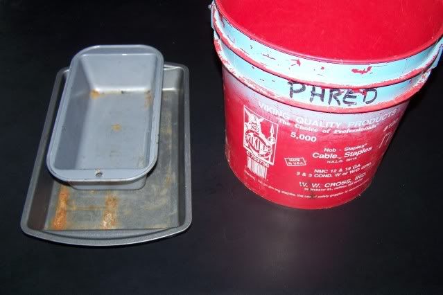

and various items to catch the water under and around disposers, hoses and pumps...I also have pince-off pliers but sometimes they leak and the clean-up time is just as long as pumping out the water to begin with...

Interesting way to spell Fred- Phred, is it his bucket ?

Large Ziplock bags also work well to catch water in those hard to reach places !

generic turkey baster with 1/4 inch nylon tubing...the tubing  has a coating of Sil-glide....it pulls out another  big 10 inches......for those hard to reach areas..............
