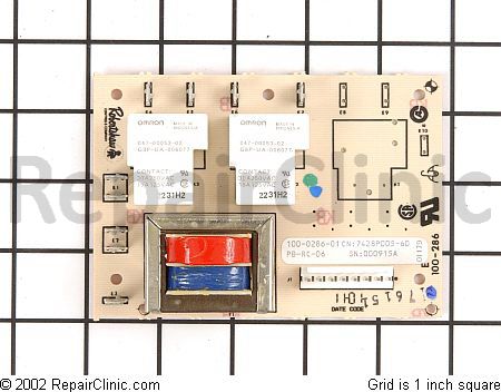

it may have one of these Relay Boards  # 12 in diagram
check to see if any of the Relay Coils get energized
in Bake / Broil / and Slow Bake
