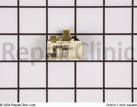

#10 appl.tech.29501
appl.tech.29501
  • 8,019 posts
Posted 21 August 2010 - 10:02 AM
[user=69990]J.C. Beat[/user] wrote:
I have continuity across the 2 prongs infront of the overload device. From front of device to rear, no continuity. I think this means overload is OK.
So it seems "compressor, overload, relay" might be OK. Then what else might prevent compresser from starting ? Could it be the Adaptive Defrost Control and is there a way to test that with a voltage, amm, resitance meters.
This is your overload..you should have continuity form the male gold terminal to the female round silver terminal that plugs onto the compressor. Do not install a hard start until we know whats going on.

#12 appl.tech.29501
appl.tech.29501
  • 8,019 posts
Posted 21 August 2010 - 10:36 AM
correcta mundo, its bad
come and get her Over load Link or you may want to replace the relay at the same time (recommended)
Cross your fingers...sometimes they just go bad, usually they go bad when the compressors are drawing alot of amps or are shorted to ground...you may not be out of the woods yet but you do need a new one to proceed.
