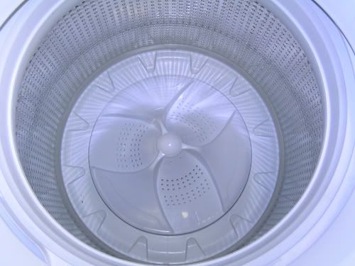

Here is the machine:

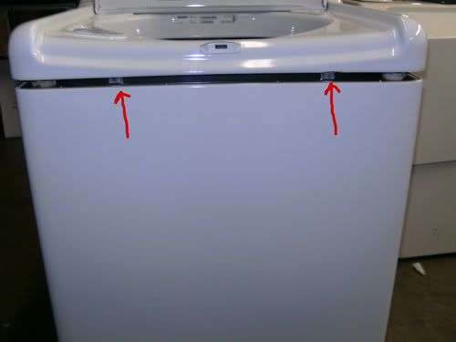

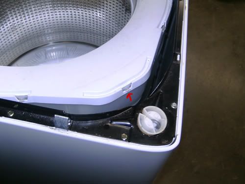

1. Open the top lid by depressing the tabs with a butter knife or putty knife between the top and cabinet. The picture below shows the top opened and the clips that you need to depress.
2. Prop the lid up against the wall so it stays at a 90 degree angle.

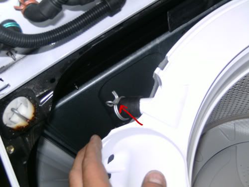

3. Remove the tub ring by releasing the tabs on the side and removing the recirculation hose by releasing the clamp.

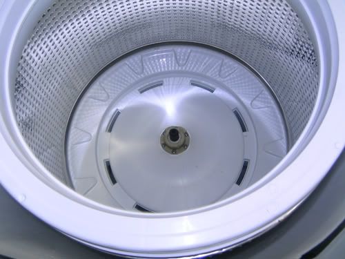

4. Remove the wash plate bolt cover. There is a slot that meets with one of the wash plate "fins". Remove the wash plate by removing the 7/16in bolt. Pull up on the wash plate with a pair of pliers to remove it from the shaft. This will expose the wash plate shaft and basket hub.

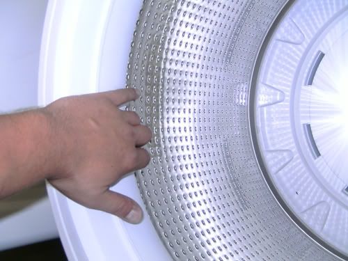

5. Remove the basket by holding the inside of the balance ring and pulling straight up. Sometimes, corrosion gets stuck on the shaft making it very difficult to remove the basket. If you have this issue, fill the machine with a hose and the basket will start to float. keep filling it while pulling up on the basket then pushing it down again. BE SURE your drain hose is still in the stand pipe or you will have a mess. Eventually, the pressure of you pulling up and down and the pressure of the water lifting the basket should free up the corrosion and allow you to free it. then drain the water by putting the machine in a drain/spin only mode or by using a Wet/Dry vac. In the field, we use a Pony Pump.
