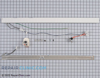

WOAH WOAH WAIT!!! If you look at the drain trough, does it look like a frozen waterfall? If so, it is NOT your defrost drain heater. You need to install a 4-20-148-0 Heater package. it comes with two heaters... USE BOTH! some techs will only install the auxilliary heater and not replace the drain trough heater... REPLACE IT! even if the original ohms out good. I will peel the old one off and use a heat gun to warm up the drain trough. then stick the new one on.
Also, take a turkey baster and flush that drain out as well when all is defrosted, make sure that is clear as well.
#7 RegUS_PatOff
  • 30,262 posts
Posted 15 November 2010 - 06:54 AM
[user=9641]DrFrige[/user] wrote:
.. 4-20-148-0 Heater package. it comes with two heaters... USE BOTH! ..
http://www.repaircli...?R=154&N=819008
You friggin rock Reg! :D
That is the package!

The whole drain trough is solid ice all the across and I'd say it kinda looks like a waterfall.  So its the trough heater that's my problem?  There is a stainless wire that goes into the drain tube.  Could that be bad too?  Is this part of the heater kit, i don't see it in the picture?

It is not part of the kit, However it is one of those situations where, the cost of the part is minimal vs, the time to de-ice and get to it. If it were MY refrigerator, I would replace it just for peace of mind. And I would ohm it out as well, if the old one is good, I would now have a backup spare should the other one go out. I keep them on the truck so when I have it apart, I can ohm it out and if the customer needs it, I have it.
But in your situation where you want to do this once and forget about it, change it.
Allow yourself a good two hours to do this. TAKE YOUR TIME!!! do not scrape or break out the ice, use a hair dryer or heat gun (If you just opt to turn the freezer off to de ice it, make sure that drain pan does not overflow and water all over your floor.)
remove the icemaker, then the 4 screws holding up that crisper glass shelf. After you remove the ice from the drain trough, is there frost on the back wall? If so, you are going to have to remove the back panel. to do this, DISCONNECT ELECTRICAL POWER TO THE FREEZER EITHER BY UNPLUGGING IT OR TURNING OFF THE CIRCUIT BREAKER! (That was from my old technical manual writing days) remove the light shield on top, you will see a grille for your evaporator fan blade, there are two stainless screws you remove. Now remove the grille and the back panel should come forward. disconnect the pwer and ground wires from your cold control and you will now be able to free that panel from the unit. Once again, use a hair dryer to de ice it.
Take your time in assembling the new heater in place... CAREFULLY tuck the wires behind the channel (you will see what I mean as you progress) make sure none of them are pinched when you tighten it all back together.
Sounds scary but it isn't, just read the directions that come with the heater very carefully and you can do it.
Good luck!!!

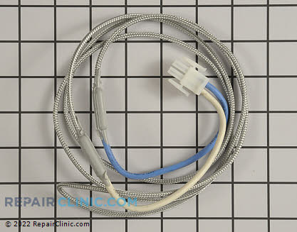

should the defrost terminator be clipped to the center top of the evap?  I took the evap cover off and it was just hanging not clipped to anything.  It looked right by the length of the wires that it should be clipped there.   i unhooked and checked the resistance and it read open.  should it be open when at room temp?  Also part of the defrost heater coil was not pressed into the evap coil.  is this normal?  this would probably be causing poor transfer of heat to deice the coils right?
#16 rat454
rat454
  • 13 posts
Posted 15 November 2010 - 04:39 PM
what is the defrost terminator's purpose.  when i look at diagrams online for a 501f  it is not in the same place as mine.  its on the left top facing the freezer.  I found an ice maker for $55 at filter outlet.com  part # RIM900.  says its a replacement for 4200520.  What do you think.  much better price than 130 everywhere else ive seen.

Defrost Terminator should be clipped onto the Evaporator ..
Defrost Terminator should be open at room tempearture.. that's it's purpose,
to stop the Defrost when it gets warm.

I turned the defrost timer to make the defrost cycle start.  The drain tube wire were hot and the wires got hot but the evap heater was not hot.  The evap heater showed no voltage.  I bypassed the terminator and got hot.  Is my terminator bad?  I could check it by putting a heat source (hair dryer)  to right?
#19 rat454
rat454
  • 13 posts
Posted 15 November 2010 - 05:14 PM
Should'nt the terminator be closed until it gets warm after the defrost cycle nears its end then open and stop current and heat flow?
#20 rat454
rat454
  • 13 posts
Posted 15 November 2010 - 05:28 PM
The terminator latches the current flow to the evap heater correct.  When the evap is cold the terminator is closed and allows current flow.  The defrost timer turns the compressor off when in defrost cycle and the evap eventually raises in temp from the evap heater and in turn heats the terminator causing it to reach temp then go open.  By then the defrost timer times out and the cooling cycle turns back on and the terminator waits for another defrost cycle correct?  i believe my terminator is bad.  i checked ohms with a hair dryer on it and it kept reading open.
