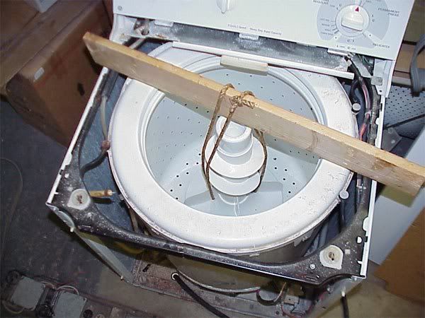

How do I take the agitator off? just pull it like a champ? because it seems it holds very well...
    Your Sometimes-Lucid Host
  • 24,268 posts
Posted 14 February 2011 - 04:14 PM
Well, you could pull like a champ (or perhaps a chimp would have more oomph?) Or you could use that gray muck swirling betwixt your ears and rig up something like this:

Posted 14 February 2011 - 07:12 PM
Thank you for your guidance.
I pulled out the agitator and squeaking is really really low now, even with large load of water
I put it back and squeaking remained very low.
Now that means it's still the transmission or it needs some grease somewhere? :unsure:
