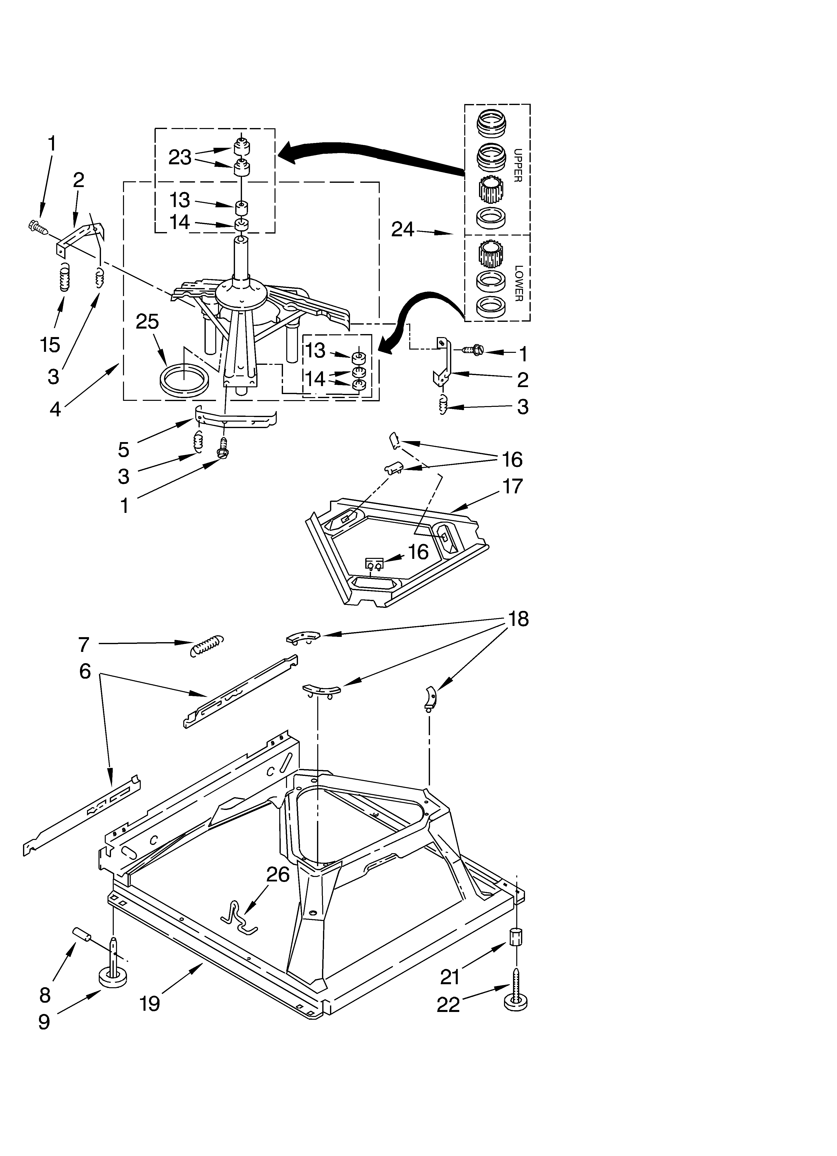

The Washer tub is listing to the right side of the washer cabinet. What parts need to be Checked/replaced?

check all (3) Springs # 3
and the Spring # 15

After you check your springs make sure to engage self balancing mechanism (part no. 6) by tilting machine forward on the front two legs, then letting machine back down.
