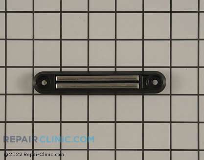

Ok i just tried an inteli dry cycle and the heat worked...then i tried it again and the heat didnt work and the dampness indicator goes from damp to wet and the clothes in the dryer are BARELY even damp....hmmm?
#8 Jay79
Jay79
  • Grasshoppah
  • 13 posts
Posted 01 March 2011 - 05:27 PM
And I also unscrewed the sensor bar and cleaned it as much as i could....when I took it off i noticed it has a total of 4 terminals(2 on each end) the only wires that are connected to it are 2 on one end of the sensor..the two terminals on the other side are not connected to anything and they are bent almost flat against the sensor...is this normal?

In the Auto-Dry Cycle, the Timer won't move until the Sensor senses the clothes are nearly dry.
If there's no heat, the Timer won't move (on the Auto-Dry Cycle)
Does the Ignitor glow at all ?
