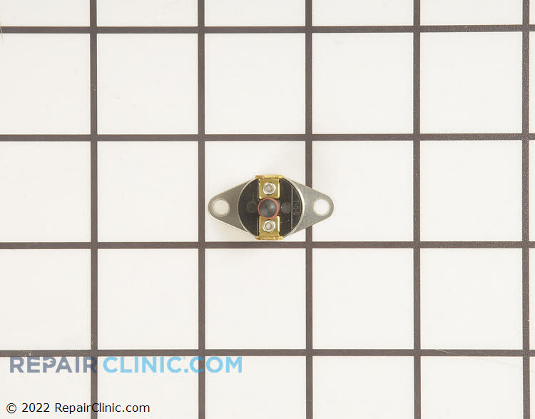

#5 kdog
    RoughShod
  • Appliantology Fellow
  • 7,465 posts
  • Location: Canada
Posted 02 March 2011 - 09:14 PM
These are resettable, they are wired in series with the sensor and trip out during self clean. Located close to the area where the probe harness passes through the liner at back of oven. If you reset it, it may (likely) trip again during next clean - has been an issue, have placed thin washers under mtg screws and instructed user to move range out a few inches prior to cleaning. This mostly 'cause I hate callbacks

#7 kdog
    RoughShod
  • 7,465 posts
  • Location: Canada
Posted 02 March 2011 - 11:12 PM
Oops! forgot to paste the picture of the thermodisc there, will post it now ............
Part number: AP3874781

#9 kdog
    RoughShod
  • 7,465 posts
  • Location: Canada
Posted 02 March 2011 - 11:16 PM
Yes, the thermodisc is in series with the oven probe
#10 RegUS_PatOff
  • Academy Instructor
  • 33,588 posts
Posted 02 March 2011 - 11:22 PM
ahh, yes, now I see it
I think I need my eyes checked again
