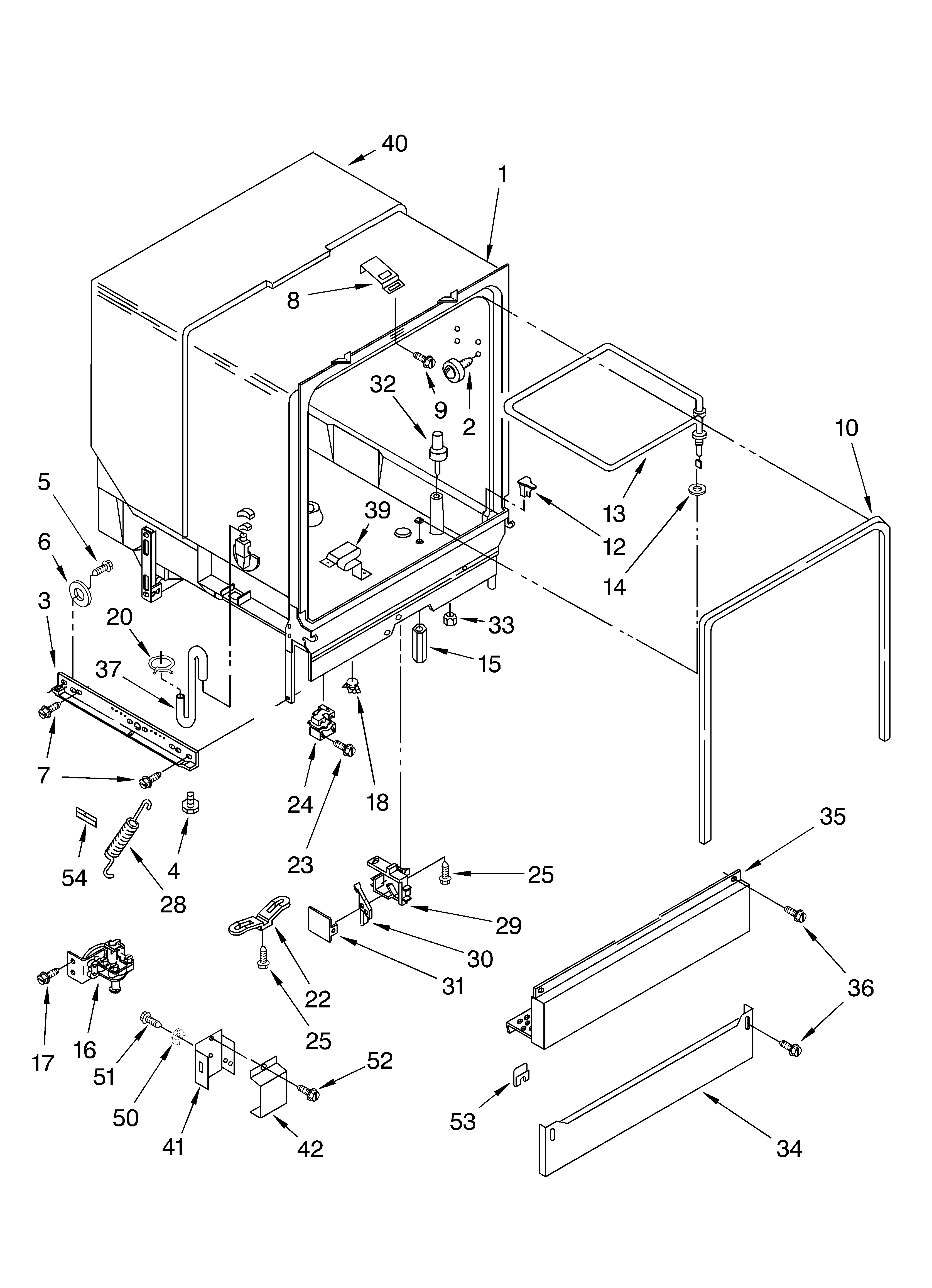

Thermostats:/ there's (2)
one in the Heater circuit = Hi-Limit Thermostat
the other Thermostat delays the Timer (till the water is hot ? )
did you test / replace the right one ?

Hi-Limit Tub Thermostat # 18 Normally Closed
Cycling Thermostat # 37 Normally Closed

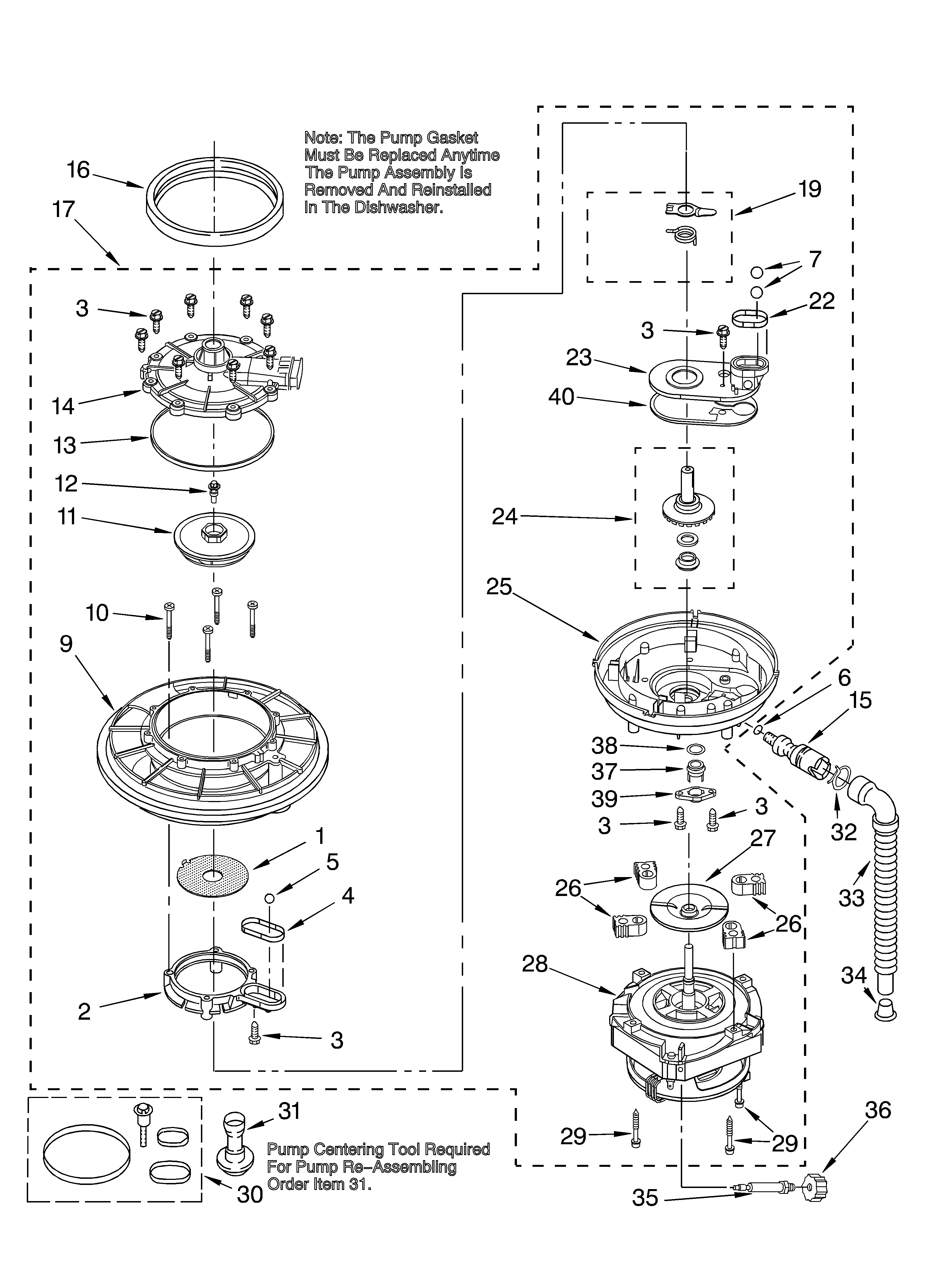

I plan on ordering the part once I determine if I can do it myself. In attempting to understand the diagram it seems I will need to remove the pump, as well as replace gasket and purchase the centering tool. Or is there a way to access the thermostat without doing all this?

The thermostat that cycles on the heating delay on this unit is key #37 in the second illustration - it can be accessed under the dishwasher, stat is mounted in the bottom of pump housing with 2, 1/4" hex screws - no need to disassemble pump module - perhaps a wire has been knocked off of it all along
