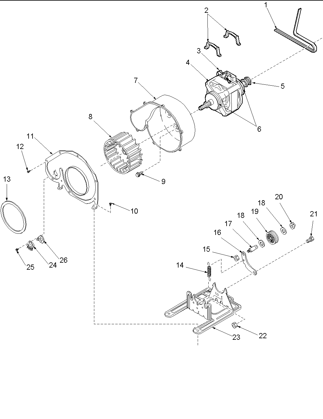

My Amana gas dryer dries fine. Model number LGA30AW. Gets very hot and dries the clothes fine.
The problem is this: the longer it runs, the louder it gets. Not a thump-thump-thump loud.
Not a squealing high-pitched noise. Just an overall, exponential increase in volume.
It becomes LOUD.

7 minutes, 22 seconds of cinematic bliss! I hope you can hear the difference from the first frames
compared to the last. It starts to get louder at about the 3:10 mark, which is about 30, maybe
35 minutes intoi the drying cycle.

Does it make that same hum if you run it for the same length of time on a no-heat cycle? If so, then I agree with kdog-- new motor time.

I just turned the dryer on again. No heat. So far, it's quiet.
Share this post
Link to post
Share on other sites
It's almost been an hour. Still running quiet. Not the motor? What can I test next?

for sure it will need a new fan and check the motor end play, any more than 1/16 and you will need a new motor also (very common)- How's the vent? If they over heat the fan will warp (grow) and hit the housing. You will see marks on the metal cover if this is the problem

yes, but sounds like a Blower Wheel problem to me . .

Blower Wheel hitting the Blower Housing, Motor Shaft end-play
(Blower Wheel mounted on Motor Shaft)

So I got the front off this thing. Drum's still on. I see the blower wheel.
The motor's behind it. Now what? Do I take the drum off?

edges of Blower Wheel could be hitting the Box (when hot),
OR too much play in the Motor Shaft

Hi,
Check the motor armature shaft endplay by grasping the blower wheel and applying axial force to check for excessive clearance. Excessive play will require either replacement or overhaul (if possible).
In other words, if it jiggles alot, put a new one.

Nothing at all sideways. Feels pretty tight to me.
