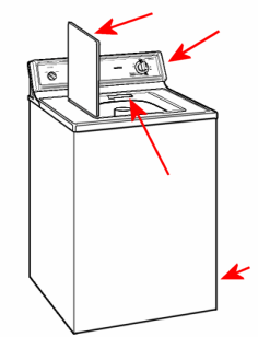

Unfotunately, Oh Great Samuri, finding the model number seems beyond my puny skills. I have looked both inside and outside. I have found places with glue that perhaps had a plate or sticker, but no model number.

#5 RegUS_PatOff
  • 30,249 posts
Posted 23 March 2011 - 10:31 PM
... finding the model number seems beyond my puny skills. I have looked both inside and outside.
... I have found places with glue that perhaps had a plate or sticker, but no model number.
Speed Queen Top-Loading Washer
Tag Location:
On newer models the identification tag
may be on the top or side of the control console,
on the side of the cabinet, around the lid opening
or on the underside of the lid.
On older models the identification tag is often found in plain view
on the front edge of the cabinet toward the base.
