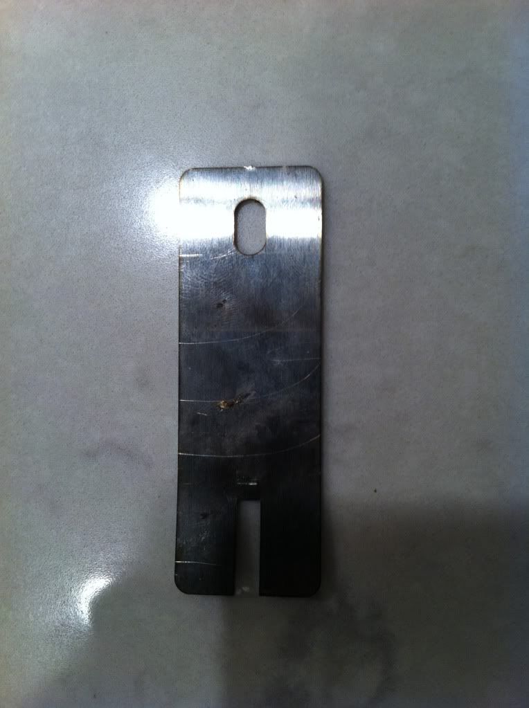

When I got home last night, I had a look at the hinges, and noticed that the rectangular metal plates that cover the hinges on the oven (not the door) were slightly bent. When I removed these plates (easy to do as they are held in with a single screw each), the oven closed and did not cause the control panel to get so hot. On the other hand, when I did this, a lot of heat came from the vents behind the burners - the vents at the back of the range.
So, my two questions - is there any harm in removing the metal plates altogether? Also, should there be so much heat coming from the back of the range?
Here are two photos - the first is the metal plate and the second shows (albeit blurry) how it is slightly bent when placed on a flat surface.

Posted 06 April 2011 - 11:31 AM
From the photo it looks like the plates are cosmetic. But inspect closely to what the screw was attached to so you can be certain. An oven like this does vent from the rear.

Thanks for your response. I am pleased to hear that the heat coming from the rear of the range is not a problem. It appears as if the screws (about 1/2 inch long) are going into the frame of the oven as they cover the hinges. They do look cosmetic, so this may have saved me a $139 service call!
