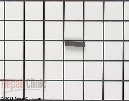

#5 RegUS_PatOff
  • 30,242 posts
Posted 09 April 2011 - 11:06 AM
Dispenser Drawer closed ?
and Drawer Magnet in-place
(bottom front of Drawer)

The door is closed and the do code on the board goes off when it's closed. The magnet is missing. Would the magnet being missing cause the machine to not start?

Does the magnet activate the REED SWITCH?
#9 prcnc
prcnc
  • 7 posts
Posted 09 April 2011 - 01:37 PM
OK, the magnet is on the dispenser drawer. Don't ask...
So I guess we're back to the door locking mechanism....
