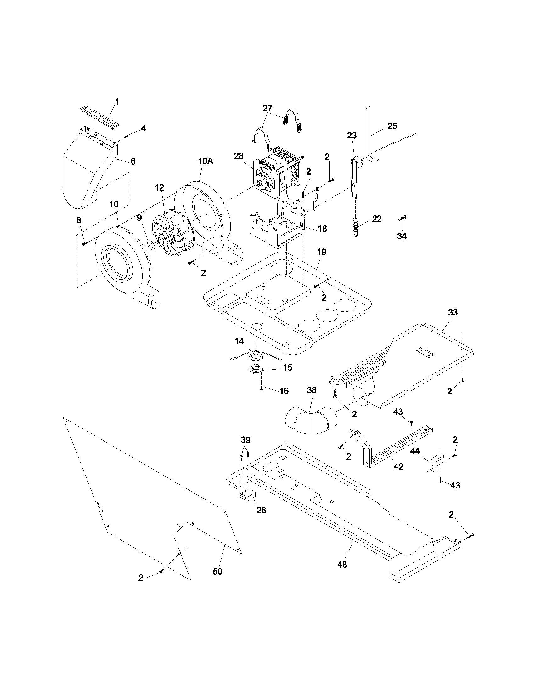

This dryer makes a loud vibration noise (sounds terrible), and within 20 seconds, the thermal or overload switch turns the motor off. About 10 minutes later, you can turn it on again to the same terrible noise and overload. I took the belt off to see if it was the rollers or anything else, still makes that loud noise and pops. I read the other side is attached to the blower fan. Was wondering if that can get clogged and make noises, or if my motor is just bad.
Any help is appreciated. And I can't get a good answer on the replacement motor - seems there are so many models that apparently fit this. Thanks!

If there's something caught in the blower, it can put enough extra load on the motor to make it draw more current and kick out on thermal overload.
#4 certified tech group 51
  • 2,503 posts
Posted 19 April 2011 - 11:05 AM
The blower possibly lost the flat on the "D" ..........(part of the shaft hub)..... Blower P/N 131476300 plus new clamp p/n 5303304824.......... Remove the panel between washer and dryer sections...Remove #50 safety panel.. remove #4, screws......... remove #6, duct........remove the screw holding on the exhaust elbow.......... remove the clamp ( I have seen a 'C' clip on the motor shaft on some models )......remove the screws holding the outer blower housing and pull the top part of the blower towards you and down wards....... pull blower off and slip it up and out.........Install in the reverse order....TEST unit after assy....

I have the whole dryer apart, but can't seem to get the blower wheel off, and I can't get the #27 clamps off that hold the motor down.
-Is there a special way to remove those clamps that hold the motor in place?

I got the new motor in, but the blower fan wheel was clamped on (no wonder it didn't unscrew out!). That wheel is broken too...
FYI anyone getting the blower fan out, you have to remove that panel in the front that goes between the washer and dryer. Then you can get the screws out that can't be reached from above.
The motor clamps have an indent toward one end that you can just push down on with a screw driver until it unhooks... the back one comes out first, then the front one appears after the whole blower housing is removed.
