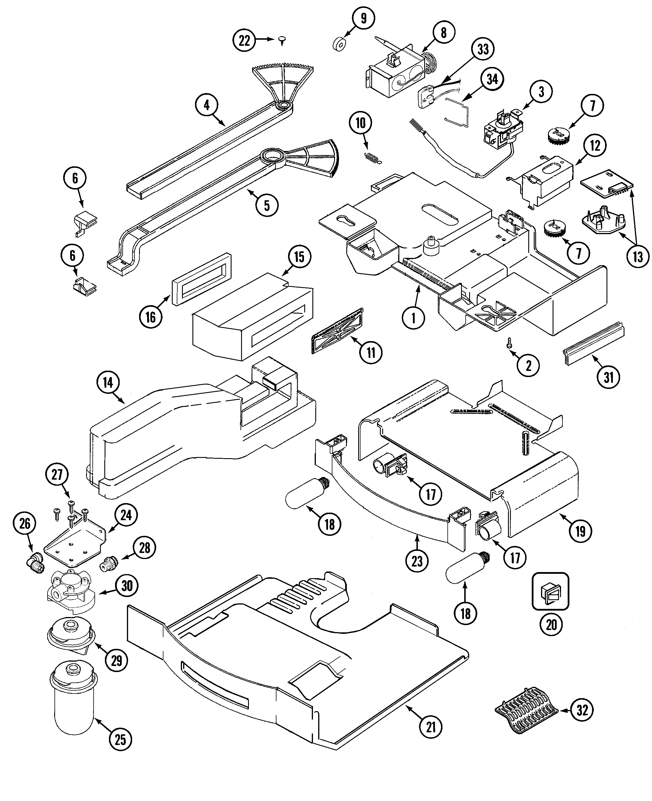

what's the Freezer temperature ?
Is the Fridge Damper Door # 11 closing when the Fridge is cold enough ?

... IS THIS THE SAME PROBLEM AS GE AND THEIR DAMPER MOTORS?
Yes. There's a tech bulletin out on this. You need to replace the autodamper assembly.
