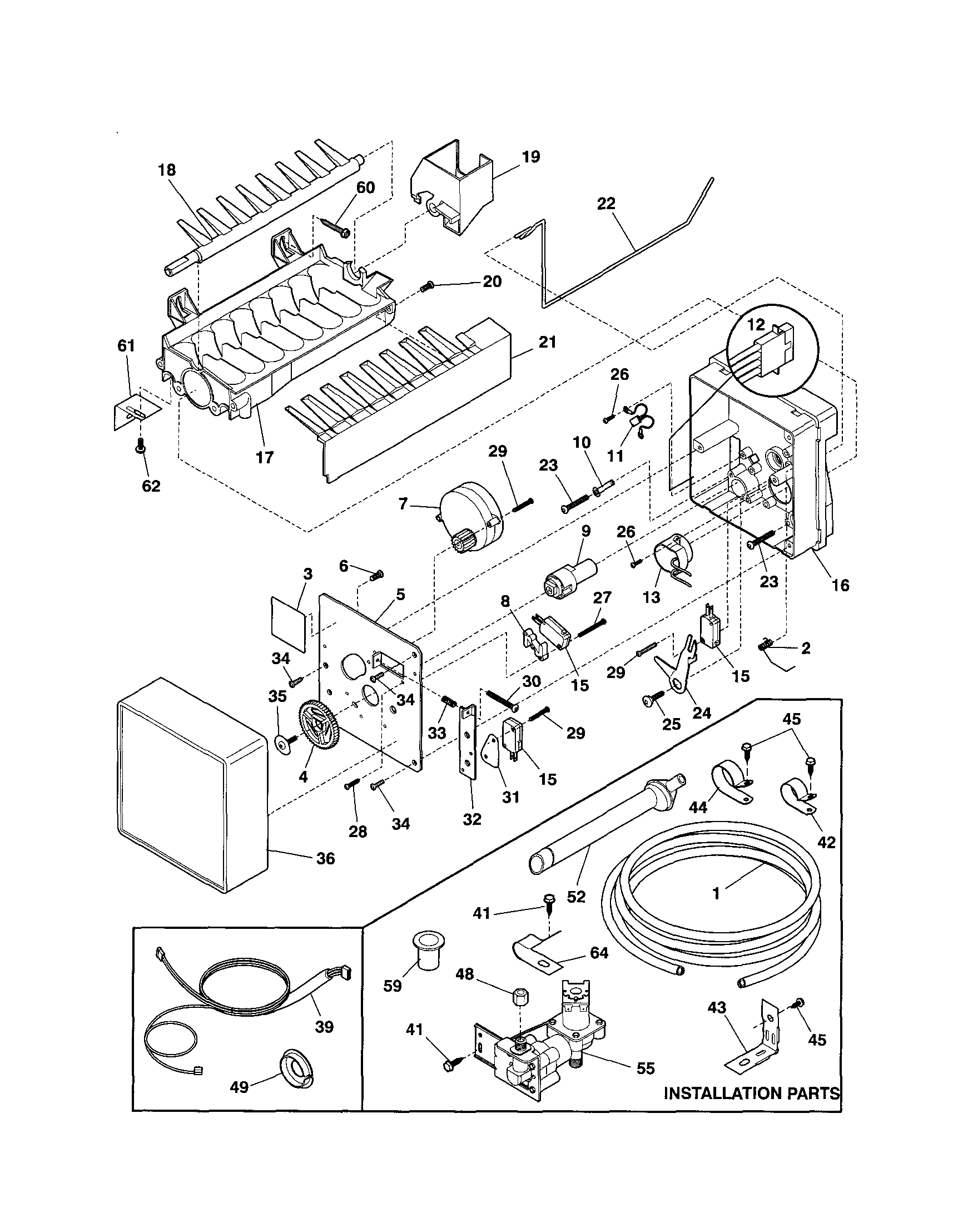

I have an ice maker model #M1 SA 8868 in my white westinghouse side by side. I had to take the cover front panel off of it to do some test and found out the problem and got it working again. However my problem is that there is a spring that fell off when opening the cover. I am pretty sure that the spring goes on the shut off arm somehow but I can't figure out how. Was wondering if anyone has a picture or exploded view of the inside of on of these ice makers so I can see how the spring is to be placed in it. If I can get the spring back in the machine should be working again. Thanks for the help.

# 2 Spring
(rear)
# 33 Spring (front)
