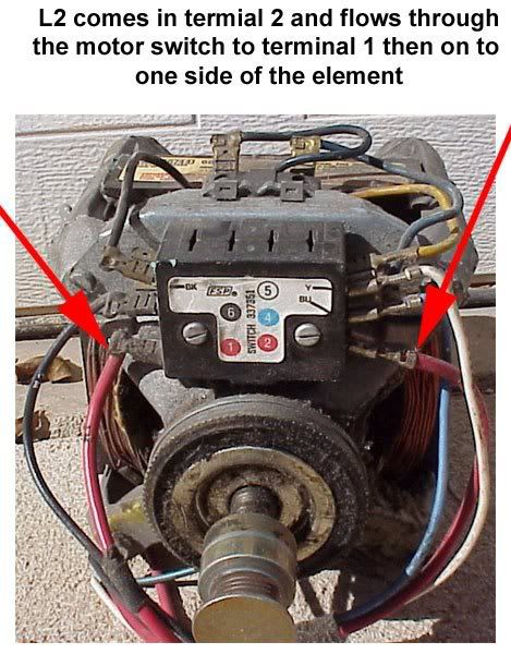

Posted 14 May 2011 - 04:03 PM
NOW, test voltage on Motor pin 4M (maybe Blue wire) to chassis
and also from Pin 4M to Pin 5M (maybe White wire)
(while someone pushes the Start Switch)
on Motor Switch as shown in diagram
    Shōgun
  • Master Samurai Tech
  • 30,209 posts
Posted 14 May 2011 - 04:09 PM
Motor switch will look something like (maybe exactly like) this...

so understand about the 4M to the chassis
but 4M to 5M what am I looking for 120v again.
