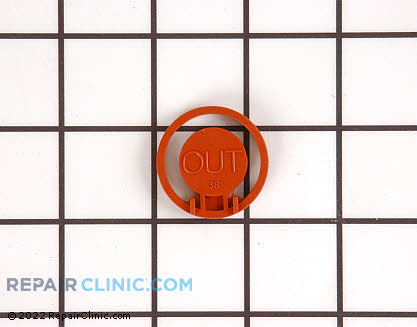

The front of the coarse filter lifts up a little bit but it is held down by the sump filter assy. What else can I check to keep crud from clogging the spray arms?
I buy all my appliance parts right here with a one-year return policy!
#18 Samurai Appliance Repair Man
    Shōgun
  • Master Samurai Tech
  • 30,577 posts
Posted 09 June 2011 - 03:35 PM
That flapper valve, item 328 in the diagram Master Reg posted for you, is prone to hydrological processes called gookification and distortification. Go ahead and replace it:
