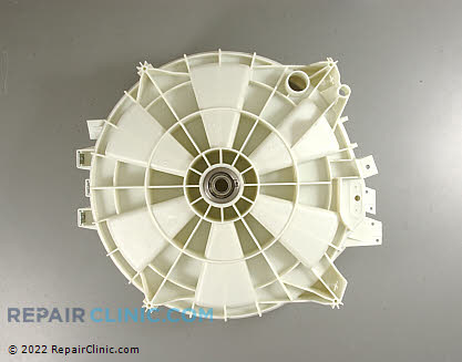

I have a whirlpool front load washer Model WFW8300SW04 - last weekend it decided to start making a huge banging sound on the final spin. I immediatly stopped it, thought the load was unbalanced, so started the machine again. It started to make the banging noise again, I knew something was seriously wrong. My first thought was the shocks were broken, they were fine.
Last night I stripped the machine down and my fears came true, the inner tub 3 spoke gear (not sure what it is called) is cracked. The bearings are fine, in fact they still look new. But the part that is cracked is so corroded, i was shocked when I saw it. as everything esle looked so clean.
The question i have is, I know I will need to replace the inner tub, will anything else need to be replaced?
in the picture the part(s) i need is #11
I have given everything the once over and it is all in good working order. There is no damage to the outer tub, and the shocks are in suprisingly good shape, they look new.
Thanks in advance.

Another washing machine enters the Metallic Misery Hall of Shame.
In addition to the inner basket assembly, you may need to replace the outer tub as well. This is because the tub bearing may have gotten damaged from all that wallowing and banging on with the drum and the bearing isn't sold separately-- it's factory installed into a new outer tub.

How would I know if the outer tub was damaged? I have inspected it thoroughly, and it looks fantastic, the bearings look brand new like they were just installed, unless I am missing something.

Not sure if this makes a difference, but the spider is cracked in 2 places, not broken throughl. The bearings show no sign of wear, like I said in my last post, they look brand new.

You can't always tell visually. Sometimes, you go through all the pain of installing a new inner basket, put it back together, and take it for a test spin only to hear that sickening jet-engine roar of bad bearings. Ax me how I know. Having been burned in this manner, I won't do this job unless the customer goes for replacing both inner basket and outer tub. Result: they all just buy a new machine.
The bearings may or may not be okay, you won't know until it's all back together. So the question you gotta ax yourself is the same one posed by Clint Eastwood as Dirty Harry when offering sage wisdom to the young man, "Do you feel lucky, punk?"

If the machine was quite in spin before the spider broke then most likely seal and bearings are OK.
You don't have to replace the complete spin basket with the spider attached,(ref#11), in the Duet SPORTS. You can purchase just the spider/shaft assembly for the Duet SPORTS, ref#27 in the parts break down picture.
Much more of a reasonable price and also don't get hit with an extra $50+ shipping charge for over-sized package shipment.
Spider only - $62.95
http://www.repairclinic.com/PartDetail/Support/1551560?modelNumber=WFW8300SW04
Complete basket with spider/shaft - $173.35
http://www.repairclinic.com/PartDetail/Basket-complete/1179958?modelNumber=WFW8300SW04

I fixed my washing machine, and it has been running trouble free for over a month. I decided to only replace the inner drum as the bearings on the outer drum were not damaged. It took me about 2.5 hours to re assemble the machine. It was a lot of work, I am sure a trained repair person could have done it faster, however, the cost was not worth it. So I took the plunge and did it myself.
