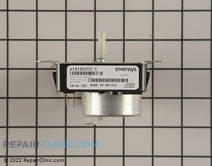

> i have roper dryer the timer went out so i ordered one online when it came in it looked different so i contacted the website i purchased it from and they assured me it was right one and will work just remove wiring plastic caps and just plug the plugs on to the prongs BAD IDEA so to make long story short i have corect timer now but have no clue which wire goes where the wire are colored but the replacement timer prong or Marked as A B C X etc the part number is W10185972 if you could somehow show me or direct me to an image of the timer hooked up i can take from the plz help me wife is on my ass and it aint good

Did the new timer have the same contacts and labeled the same??? if it did , did you move one wire at a time from timer to timer??? do you have the wire diagram for that dryer??? It will tell you the wire number/color to the correct timer terminal location..keep us posted.....did you purchase from repairclinic for a no question asked return ???? :thumbsup:

Do you have the wiring diagram doe this dryer? Should be a tech sheet cleverly hidden inside the dryer. We'll need to see that to get you back into dryer heaven.

Roper RED4440VQ1 made by Whirlpool
W10185972
http://www.repaircli...R=154&N=1481701

Dayyam, Reg, that's an awesome pinout diagram on that timer! :thumbsup:

cropped from the RED4440VQ1 tech sheet
RED4440VQ0 is a different Timer
