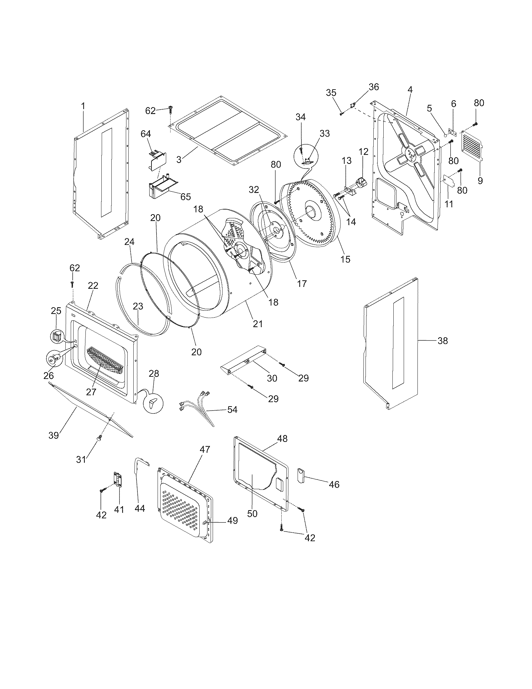

#1 jutter
jutter
  • 6 posts
Posted 23 May 2011 - 11:20 AM
From a response, "May be something caught in the blower, below the lint filter. Gonna have to take off the front panel and have a look. We can get you teardown help in the Samurai School; start a new topic in the Laundry Forum and we'll step you through it."
OK, please provide me a step thru on fixing it.
Thanks.
Jeff

#3 jutter
jutter
  • 6 posts
Posted 23 May 2011 - 12:47 PM
The drum doesn't want to turn. I'm getting power when I turn the switch.
Drum stopped turning. I can manually rotate it counter clockwise, but not clockwise.
#4 RegUS_PatOff
  • 30,257 posts
Posted 23 May 2011 - 01:01 PM
Dryer Vent
Vent should be rigid metal.
Short lengths of flexible metal may be OK, if not crimped when moving the Dryer into place.
NO plastic
NO PVC
NO screws
Foil Duct Tape is OK.
With an empty load, Timed Dry, High Heat, the vent temperature should cycle somewhere between 135F and 160F
Check / clean the Dryer Vent
Disconnect the Dryer Vent and check for good air-flow there and where it exits the house.
Check the Vent air temperature at the back of the Dryer.
check the Thermal Fuse # 36 (near top right)
http://www.repaircli...R=154&N=1489053

#9 jutter
jutter
  • 6 posts
Posted 27 July 2011 - 05:51 PM
I tried replacing the Thermal Fuse, but it still doesn't work.
Any more suggestions?
