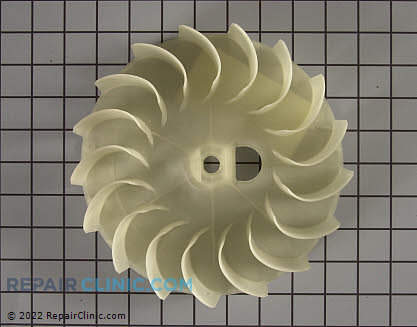

Loose blower wheels are very common on these GE dryers. I've seen it happen many times and the noise in your video is the classic case of the loose blower wheel.

That would be ideal if it were the blower wheel and not the motor. If it is loose, what is the proper way to tighten it? I see a nut on the front of it, is that the only way to tighten it? Thank you all again!

This blower wheel is held on by a "trick-but" nut-- it'll trick you into thinking it's on goodntight BUT it ain't. It can also mask a wallered out blower. Remove the bolt completely and inspect the blower wheel, compare to a new one:
(Click image for larger view)
Re-assemble, crank it down goodntight, and try it again. Let us know.
