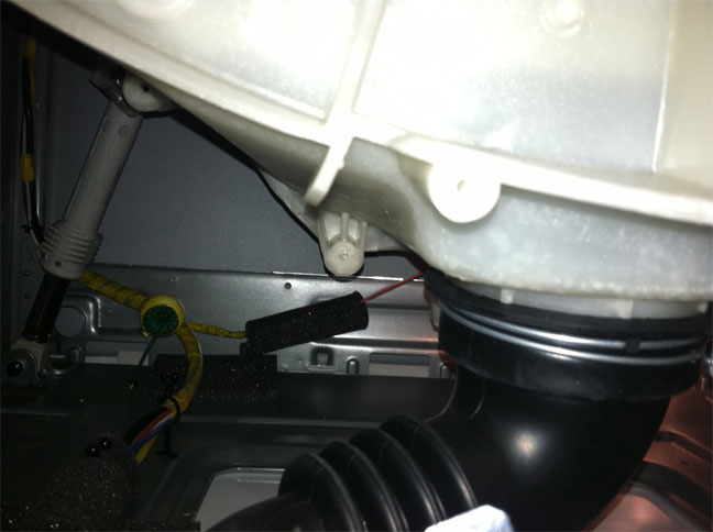

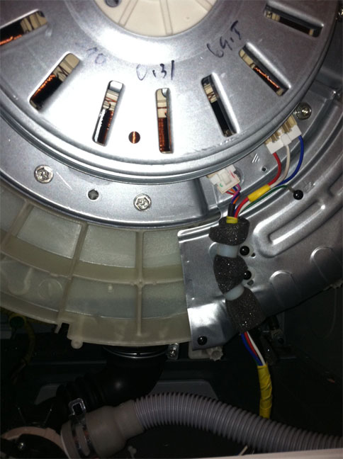

What are the chances the thermistor is actually on the front side of the tub? And is there anywhere to find a picture of said thermistor? All of the parts webistes and part diagrams I can find on this model do not include this part, or a picture of this part. Or is there a wiring diagram somewhere I can see?
Here's the view from the back of the washer:
Attached File  backwasher.jpg   59.54KB   8 downloads
And underneath the tub, coming from left hand side is this red and white wire going to the tub (please tell me this isn't likely thermistor.) I can't see exactly where it attaches to tub:
Attached File  frontwire.jpg   39.15KB   7 downloads
If this is the thermistor, how do I get the front panel off to access this?
I'm sorry I sound like an idiot. I guess I am when it comes to these things. Thanks again for your help.

#6 jnorman
jnorman
  • Grasshoppah
  • 7 posts
Posted 09 June 2011 - 06:48 PM
Trying once more with images, as I can't see the attachments.
Hope these help.
Thanks again.
#7 jnorman
jnorman
  • Grasshoppah
  • 7 posts
Posted 09 June 2011 - 07:49 PM
So, in further developments, I was able to reach the red and white wire in the front of the tub. It appears the white wire has been cut somehow, as it now attaches to nothing. However, I still can not remove the front panel to access this part of the washer. I have undone every screw I can see, including two on the bottom of the panel that appear to attach to the frame. Nothing will budge. I am also unsure how to separate the metal panel from the plastic of the control panel at the top portion of the washer.

Posted 09 June 2011 - 09:02 PM
So, after removing the top panel from the washer, I found the screws for the control panel for the washer, which I also removed, revealing the top screws for the front panel, which I also removed. I then removed the screws from the door lock/switch mechanism. This left the front panel held on by the gasket connecting to tub and the braces on the bottom of the frame where I had previously removed the screws. I could not for the life of me get the panel to budge any further.
Is there some trick to this? And how does the gasket free up from the panel to allow it to be moved?

Posted 09 June 2011 - 09:05 PM
Check the front of the tub assy.
6 O'clock location.
Newer Samsung washers have the THERMISTOR mounted at the rear of the tub.

Thanks John,
I can see the wire. Just can't get to it.

#11 john63
john63
    Dean of LG Appliantology
  • Appliantology Fellow
  • 2,151 posts
Posted 09 June 2011 - 09:11 PM
The gasket can be removed (carefully) by using a flat screwdriver.
Locate the CLAMP SPRING (again at the 6 o'clock position) on the *front panel*.
Pry the spring & remove the gasket clamp.
Using fingers---peel back the gasket from the front panel *lip*.
It is not neccesary to remove the door gasket from the tub assy.
Re-installing the spring clamp can be done using fingers (reasonable effort required).
