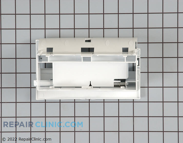

I took the drawer out and don't see a magnet on the drawer or on it's track, back of the track, no where, it's all plastic. No sign of a magnet or any place a magnet would be used????

#24 RegUS_PatOff
  • 30,264 posts
Posted 29 August 2011 - 09:23 PM
seems to be near the front of the Dispenser Drawer on that model.
Magnet is about 1" x 1/4"
http://www.repaircli...?R=154&N=407225

I'm is all plastic, it doesn't have a spring in the back, I'm going to try and send you a photo. My part number is: 134453500. No magnet on it anywhere. I do appreciate your help and continued support.

#27 RegUS_PatOff
  • 30,264 posts
Posted 29 August 2011 - 10:01 PM
... it doesn't have a spring in the back,
Magnet # 51
may be on # 49

I took it apart and finally found the magnet, it's in there. It's in the door front, found it in there when I took the face plate/door front off the body of the dispenser.

Yes the magnet is on the door.

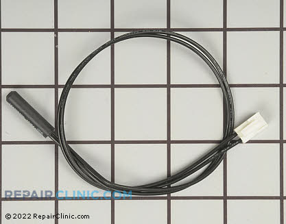

#31 RegUS_PatOff
  • 30,264 posts
Posted 30 August 2011 - 10:42 AM
from the Tech Sheet:
E14 Reed switch. Refer to test (3).
Test 3:
1. Is the dispenser drawer closed?
No. Close the drawer.
Yes. Go to step (2).
2. Remove the drawer and check the magnet.
Magnet missing or defective. Replace the magnet.
Magnet good. Go to step (3).
3. Open the console and check the reed switch.
Defective. Replace the reed switch.
Good. Replace the control board.
OR bad / broken wiring / connector ...

#33 RegUS_PatOff
  • 30,264 posts
Posted 30 August 2011 - 01:02 PM
... How do you check the reed switch which is the water intake valve assembly, correct? If the reed switch is good, which control board and where is it located?
error E14 Reed Switch has nothing to do with Water Input ..
The Reed Switch is in the Dispenser Drawer area.
It senses the Magnet when the Drawer is fully closed.
http://www.repaircli...R=154&N=1154757
For service manuals and lots of other goodies,
become an Apprentice==> http://appliantology.org/apprentice/
The Controller is # 1 in the diagram

#35 thespen
thespen
    Ikkō-ikki
  • 31 posts
  • Flavorite Brew:Lazy Magnolia pale ale
Posted 30 August 2011 - 06:25 PM
I brought home a magnet and held it next to where the end of the reed switch is and the washer still makes a hum after I hear the door lock, a solineod/switch clicks so I'm assuming the reed switch is working. I then put the drawer back in and get the same result so I assume the magnet is good. I took the magnet away from the reed switch and after about 10-15 seconds, I get a "doo" message on the display which I assume means door open so the reed switch must be working. I think I know the answer here but is it time to assume the controller board is bad? Thanks again for all the help, I suspect I was sent in the wrong direction from the start by Appliance Zone and told to buy the motor control board when I may have needed the control board. Please advise.

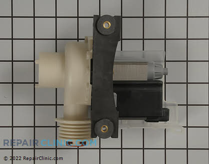

No the hum is still towards the back down low. I can't tell where it's coming from but after about 8-10 seconds it stops then 8-10 seconds later coming back on. There is something down low to the left across from the motor that's hooked to the discharge hose, could that be making the noise and putting out the E14 code?
#38 kdog
    RoughShod
  • 7,428 posts
  • Location: Canada
Posted 30 August 2011 - 06:55 PM
Does it look like this ?

#40 thespen
thespen
    Ikkō-ikki
  • 31 posts
Posted 30 August 2011 - 07:00 PM
From what I can see, yes but I can't tell if the discharge end is threaded. Part# is: 134051200
