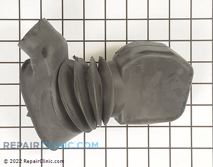

could that be a pump motor jam or bad pump motor??
Yes, if nothing is jamming the pump impeller, then the pump is shot
Make sure you check inside this as it is often full of goodies:
AKA - "Crap Trap"

Posted 01 September 2011 - 11:30 AM
Sir, You were absolutely correct, my problem was, get this, a underbra wire that manage to stick itself into the pump impeller stopping it from moving. Thank you very much and my wife thanks you!!!!! Wish I had talked to you prior to buying the motor controller which by the way, is now for sale since I can't return it. Now to move onto another honey do. I just don't understand way the code would tell me it's the reed switch. For everyone else out there, if your washer won't start running and/or hums and doesn;'t pump the water out, check the pump for blockage.
