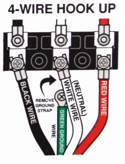

Im not the smartest guy around appliance, but i do have some hands on exp. where exactly do I have to measure for resistance and if its not 400 what is the possible cause.
#12 Samurai Appliance Repair Man
    Your Sometimes-Lucid Host
  • 24,352 posts
Posted 17 September 2011 - 02:44 PM
Here's a typical diagram of the range power cord power block. This is where the power cord connects to the range.
If you don't get 400ohms, them either the ignitor is broken, connected wrong, or there's some other wiring problem in the range.
...TGF363AUD Tappan Gas range :whistling:
should be about 400 OHMs between one or the other of the Ignitor wires to the Neutral (large, flat) Pin of the 120v Power Cord
