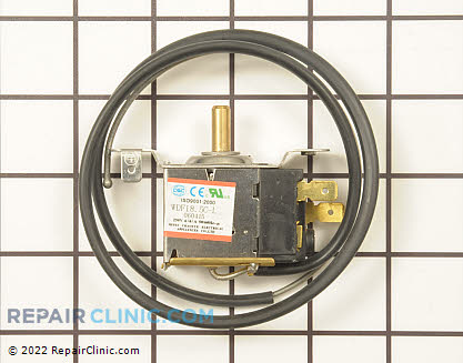

... Bought the fridge without a thermostat,
.. a standard mechanical Thermostat would have worked...
http://www.repaircli...R=154&N=1224590
Actually it didn't I:(
I forgot to put on the first post that it was the first approach, but it didn't control temperature very well (I'm thinking that the salesmans didn't understand and sold me a thermostat for frosting fridge") It was more like an on/off manual switch for the compressor
The problemis that since the Samsung's "twin cooling" system actually has 2 evaporators for just one compressor. The main difference between both cabinets is very small
fridge temp of -6ºC (~21ºF)
freezer temp of -12ºC(~20ºF)
It normally controls the ammount of refrigerating gas going to each evaporator using a 3-way valve.
That's why a normal 1-thermostat approach doesn't apply on this.
