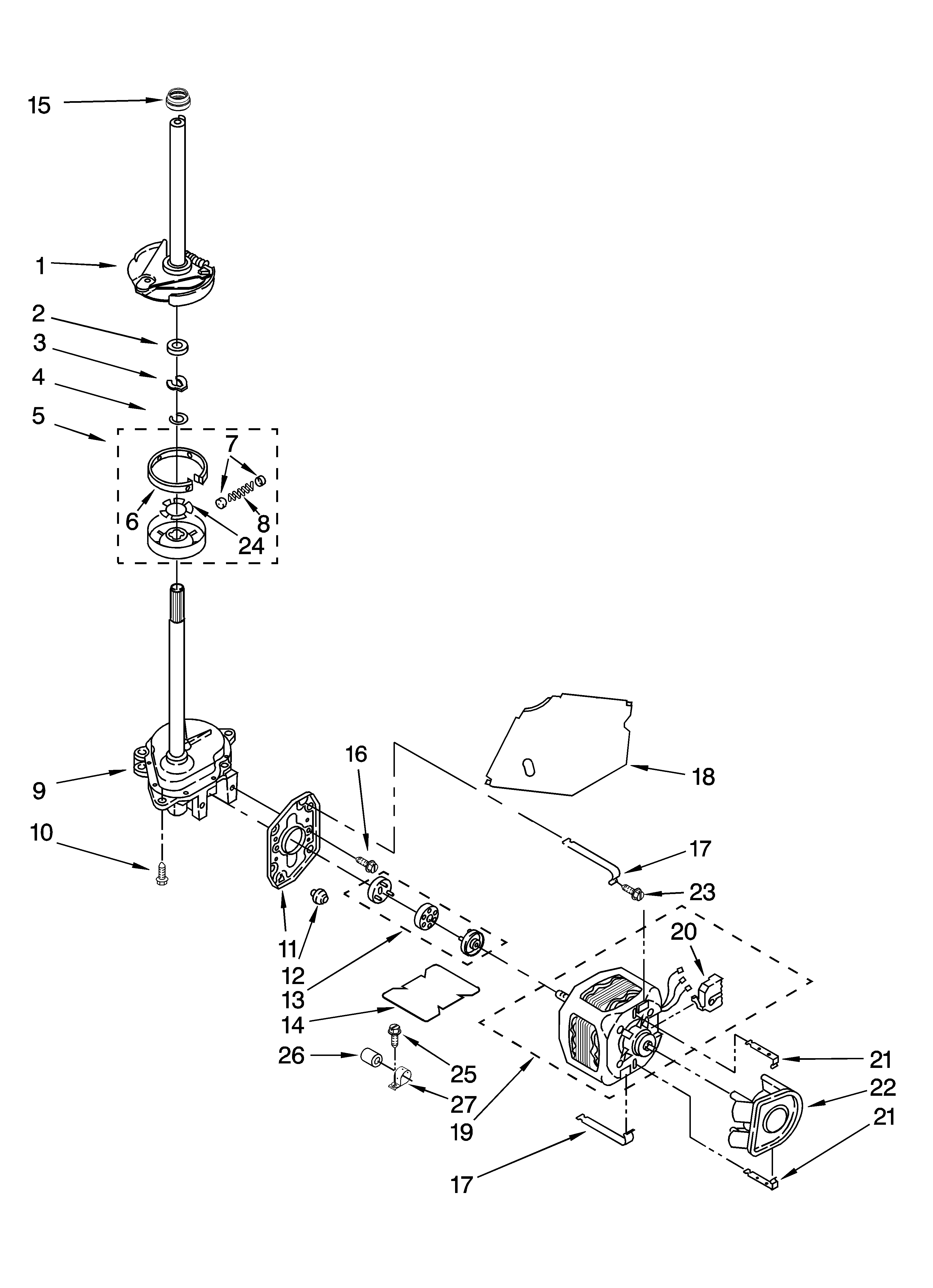

I did not remove the spanner nut, and I do not have a spanner nut wrench, but when I got to this point I pulled up on the tub and it came right out. Looking at the parts there at this point, it seems as though there is a part that has worn or broke down in some tiny pieces. I don't know which parts are which though, in order to better explain. I cleaned up the little pieces and temporarily replaced the tub and rotated it...it does the "bang" or "knocking" sound twice per rotation and I can see where these pieces are hitting. I don't know if I have a worn part that needs to be replaced or a part that has disintegrated(?) or what??? I will try to snap a pic and get it posted here in the morning, maybe that will help. I hope so.

RegUS_PatOff...Thanks for the diagram. It looks like the drive block stays attatched up in the cone of the inner tub until you remove the spanner nut (I have the inner tub removed but as I said, I have yet to remove the spanner nut. I assume it will just drop once I do get a spanner wrench and remove the nut???????)

The basket drive extends from underneath and is driven by the transmission during spin, the drive block is secured to it via the 2 shoulders on the drive tube - these shoulders on your current drive tube look somewhat damaged, you may be able to gently pry them out a bit so that they will mate to a new drive block - but if not, you'll have to replace both the block and the basket drive. if you look at the parts links from above, the spanner wrench etc. is also mentioned within the link

Drive Tube #1

I will post again then. Wish me luck! And thanks for all the great info and help. You two ROCK! :rocker: I really do appreciate it! (RegUS_PatOff...Thanks for changing that one diagram picture to an actual picture with labels, etc. That was a big help to me.)

1) Your Basket Drive is toast Tabs are gone
2) ... it was no trouble for me :whistling: Posted Image
