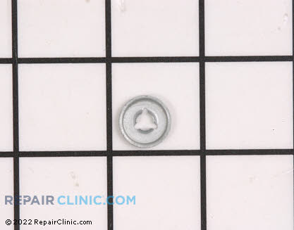

Any trick to removing the press on clip for the drain valve seal? I ordered a new one assuming it can't be reused.

Be careful trying to remove that clip, you DON'T want to just try to pry if off. If you do you could very easily pull the drain shaft out of the drain flap that is inside the pump body. It will be impossible to get it back in without remove the complete pump/motor assembly.
I use a small flat blade screwdriver and jam it into each of the three little slots and pry the edges of the inner clip area up so as to make the center hole larger so it will slip right off the shaft without pulling the shaft out of the pump body.
I've had really good results doing it that way and most of the time I'm also able to reuse the old clip by just smashing the center tabs back down a little so it will slide back on the shaft with a little pressure and clip back in the grove just in front of the seal.

Push on clip was a BEAR. Unlike the replacement the original had 8 tabs with no gap between them, no way to bend them individually. I worked at it about twenty minutes with picks of various shapes, but no go, so I as carefully as possible pried up one edge at a time until it came off. Seal came out without much trouble, but took me some time to get the new one back on and in the groove.
