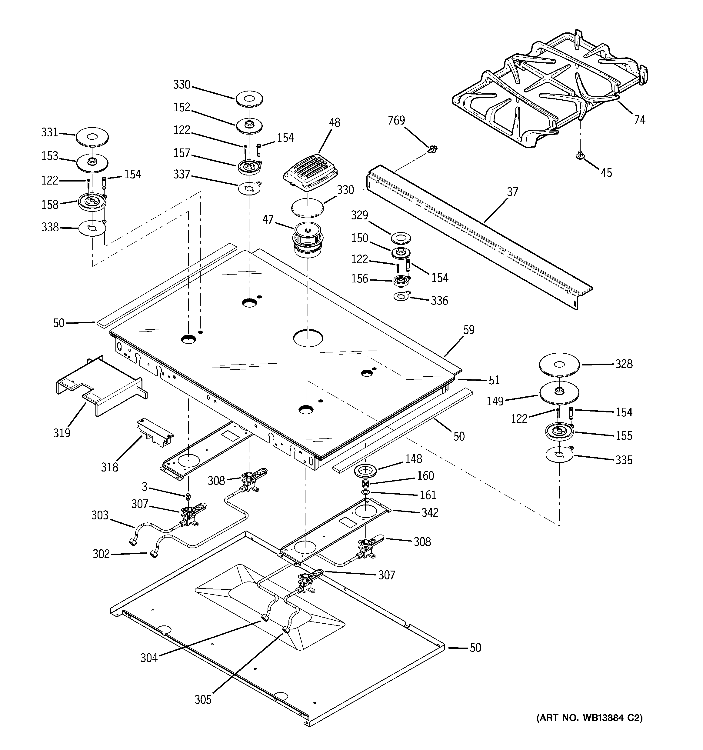

One (only) of the four gas burner igniters doesn't spark. I've checked for gunk; nothing. I suspect either the wire or the spark module port. How do I get to the spark module? This is a glass-top range. I can unscrew the Torx screws holding the burners down and, if necessary, separate the igniters from the burner bodies, but is that what is needed? What then? I'd like to try switching the wires around and so forth.
BTW -- none of the on-line parts lists I've found has a wiring diagram or a picture of the harness, nor any obvious indication of how to get to the offending box.

Posted Image 318 is the spark module, I would suspect a wire or an ignitor, before just one port on the spark module. When you use that switch do the other ignitors click?
