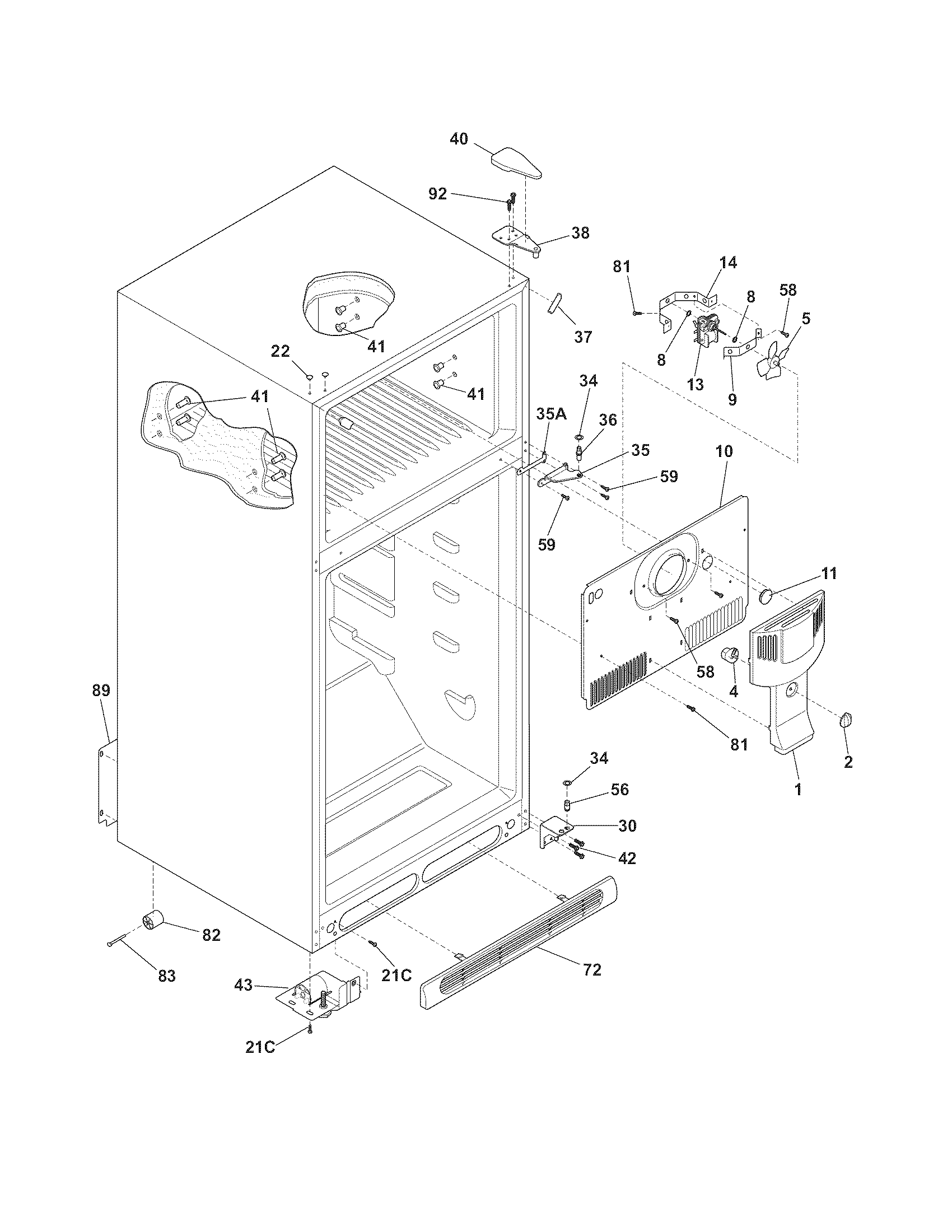

This is a fridge in my rental property, so I can only test/try things on the weekends. It is only 18 months old. It blows my mind that it is not cooling. But I also had a tenant that was removed by the local police. So not knowing if it was sabotage or not, there is electricity....it did not feel warm to me, but I did not have a thermometer with me. I will take one this weekend. Last weekend I pull the back off and checked the fan and it was running. The coils were dusty but not a lot, I vacuumed them anyway. I checked the settings and closed up the fridge. I will check it when I go back.....it is an hour drive each way. So I was really wondering if you had suggestions of what to check. I did not get the extended warranty

... the back off and checked the fan and it was running.
was the Compressor running, also ?
Would also need to check if the Freezer Fan is running
and check the frost pattern of the Evaporator Coils inside the Freezer
(picture) ?

Frigidaires (especially cheap apartment grade ones like these) have been notorious for refrigerant leaks in the evaporators. Post pictures of the frost pattern of the evaporator when you can.

yes the fan in the freezer is working, the air flows from the freezer to the fridge. Yes the compressor is running too.
When I took the back cardboard off that covers the compresser and fan and coil looking thing. I could feel cold air. For some reason it is not making to the inside of the unit.
I thought the freon was in a sealed system. So it could leak out????
Siggy
p.s. no frost pattern at all. There was no frost anywhere.

No frost pattern and compressor and condenser fan are running == sealed system problem.
Sealed system = compressor + the refrigerant tubing.
Yes, refrigerant can leak out and commonly does is sealed system failures.
Compressor failure is another sealed system problem. Usually less common than leaks but for some types of compressors, it's more common.
Either way, it doesnt matter-- sealed system failure in a cheap residential fridge is a terminal event. You're going shopping.

Compressor running and NO frost ...
Sealed System leak somewhere .. $$$
(unless you can physically see some damaged areas)
May be time to go shopping ..
