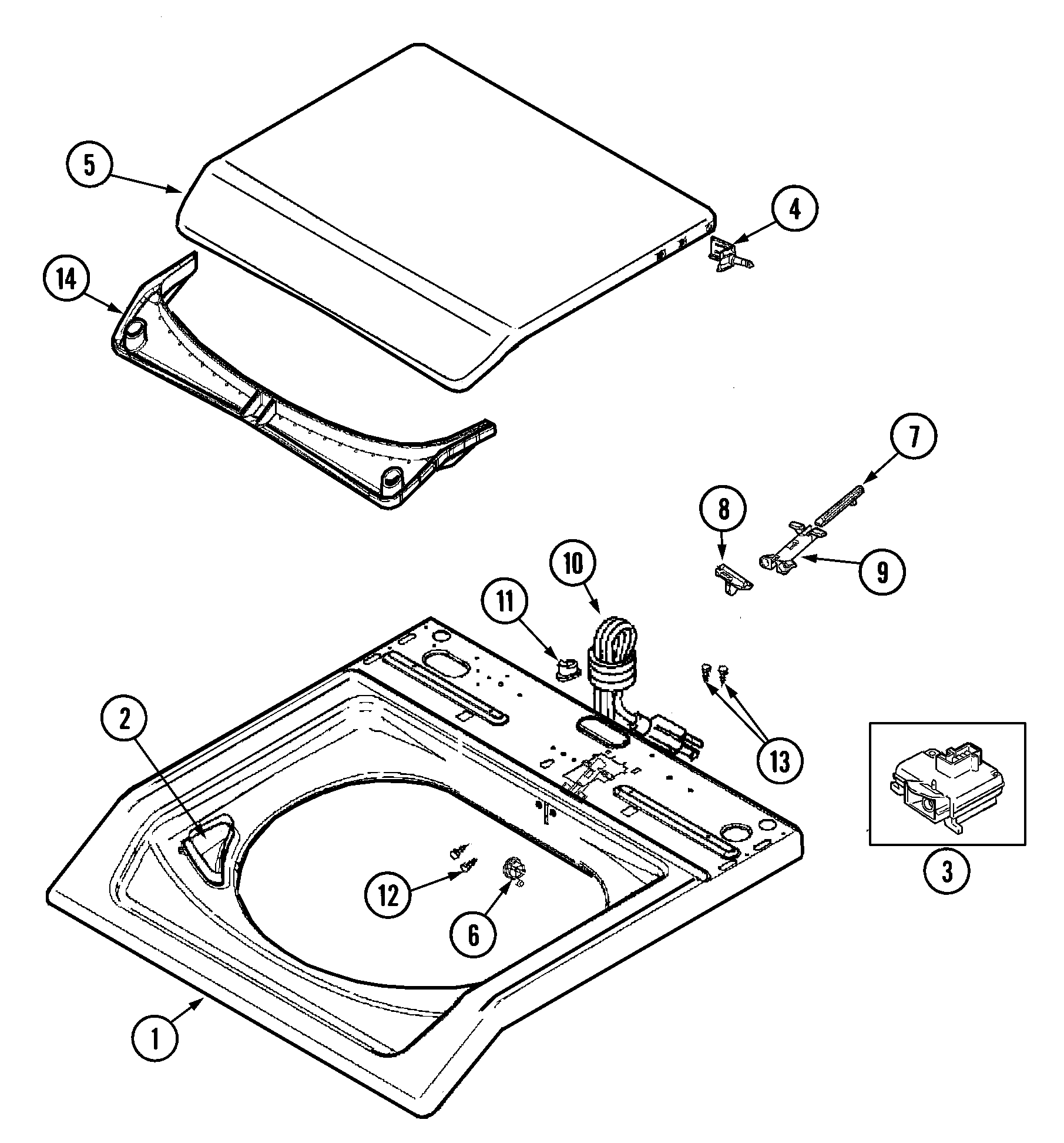

I suppose my Maytag Atlantis MAV7700AWW got a little jealous of all the time I was spending with the dryer.
Or the lid switch actuator just broke. Either way, stabbing it with a chopstick isn't a long term solution.
Tips for replacing it on my own?
Thanks!
Rachel
#2 RegUS_PatOff
  • 30,216 posts
Posted 25 October 2011 - 10:28 PM
"new Lid Switch" Bulletin
TCL-0001-B.pdf
Installation Instructions
16010951.pdf
http://www.repaircli...?R=154&N=916383
Your current Lid Switch
# 7, 8, 9
may be something loose, or needs adjustment
