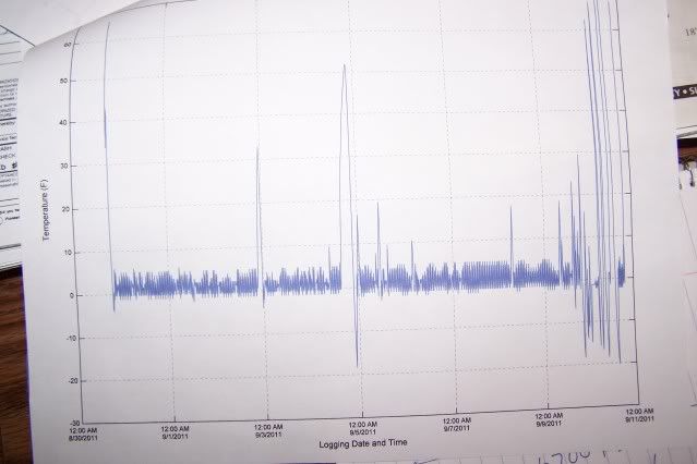

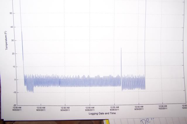

This may be relevant.....Two previous G.E. refers that I have worked on, 1) mod # I forget- ADORA was the make and the second one, M # -gth22sbnarbs....... both had the same issues...Cool correctly and then warm up for a while then start cooling correctly...Food lost every time.....On the ADORA, I started to push lightly on the components on the board, nothing until I pushed on the large capacitor.....It curled my hair. :woot: ..bleeding cap.......Replace the main board P/N WR55X10942 All is well....The second unit was brought to the warehouse and plugged in and a recorder data logger was installed....Erratic operation.......When the compressor was not running, ( but was calling for cooling ) I pushed on the components ( rubber glove this time ) when I got to the J-8..J-9....J-11.... connections I pushed on the plug and the comp. started ... removed the board but did not see anything.. reinstalled board......I pushed on the terminal when ever I was at the warehouse and the comp started.....Replace the board with WR55X10942..( and the evap fan ).. All is well.... The whole point is, the boards may look fine but the components / connections/ traces fail.... With the second G.E. I had the luxury of keeping it for 60 days.. ( gotta call the customer to come and get it )....I second what Durham App. suggests, order the board and give it a try.........
..........before board...
.....after board................Logger copies...... customers lovem
#14 kdog

Dayyam, that's some sho nuff professional looking graphs, CTG! :dude:

Posted 03 November 2011 - 09:54 AM
Supco mod# SL300............... Twice as good as the old Mod# 200... The # 300 can record one reading every 2 min. for 60 days or up to every hour for 1800 days if you need.......... mine are set for every 5 min. for 150 days...............It helps with a problematic freezer or fridge..... I have one in a freezer in a store , will monitor day and night........... helps when the customer says it will not get cold enough during the day, ( are the doors being held open too long? , doors not getting closed..... cranky cold controls ) .........Tests accuracy of their in unit thermometers.
