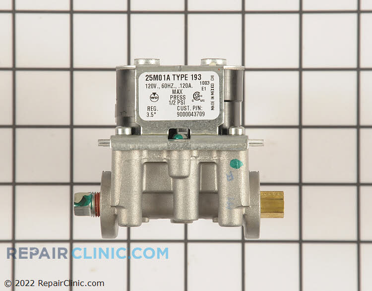

Posted 29 October 2011 - 04:05 PM
25M01A TYPE 193
Cust. P/N: 9000043709
Which seems to be this part: http://www.repaircli.../497069/1162507
Would this be natural gas or propane?
Of note, you only need to take the front circular cover off to get to the valve....
#11 RegUS_PatOff
  • 30,239 posts
Posted 29 October 2011 - 04:10 PM
if you notice on the Gas Valve and in the Parts pictures,
it mentions Reg 3.5"
That's the 3.5" under the Natural Gas info on your Oven Label posted above

Posted 29 October 2011 - 06:22 PM
My valve label looked different than the one on the repair clinic, I had to use a mirror to see it and photograph it.
I read and reread your writings for clues. Some of the things that threw me off the middle path were the (online) images of the conversion kit, the ones I saw did not show a valve so I did not think it got replaced, just the ports. You wrote that it did though so it seemed like it did. A propane dealer said I needed a regulator that was 525,000 BTUs yet the dryer is only 18,000 BTUs? I would say with your help we effectively proved that this is a natural gas dryer in it's current state.
Larger Version:
http://www.vitalbodi...1920x1080_0.jpg
Note: Bosch customer support said they do not ship propane dryers, only natural gas, but that you can convert them to propane.
#13 kdog
    RoughShod
  • 7,428 posts
  • Location: Canada
Posted 29 October 2011 - 08:51 PM
All of the Dryers that I know of are shipped initially set up for Nat. Gas. but are convertable to L.P. - The propane dealer is referring to the regulator on your "Bullet" that he refills, 525 KBtu is what the main tank can supply to fire all of your appliances which in turn have "step down" regulators of their own to provide a steady pressure. In the image that Reg posted, you can see on the sticker that the REG 3.5" - that is Nat. Gas. pressure, the sticker on your valve would say LP 11" if it has been changed over - usually this is done by a licensed individual and part of the conversion kit is an identifying sticker that is to be applied to the machine. The dual ratings on the appliance plate indicate that it is a convertable model. If you got that machine straight out of the box it is doubtful that it has been converted as there would have been some steps made to ensure it (paper trail)

Posted 30 October 2011 - 09:17 PM
My label does say REG 3.5". The unit was purchased used so I was not sure about the specs or what it came with inside. The next step is to decide if this dryer should be converted or not to propane or just go with an electric dryer.
