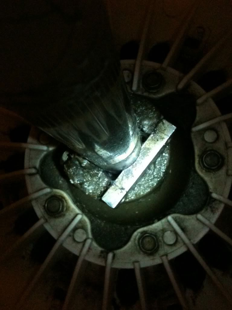

Hello,
SO I have a vary basic understanding of appliances. Enough of one to be able to replace the transmission in the washer.
It had locked up and wouldn't agitate so I had to order a new one.
After going through all that ( I had to work in an apartment building) I put it together and it makes a loud knocking sound when it really gets into the spin cycle.
I made sure to get the screws on snug that hold the base of the trani in place. and there was not one spare screw when I was done.
I've attached a link to an audio clip of the sound
Thanks a lot!
Click to hear Washer Sound
-Dave

The sound link goes to a "sign up" page - you might want to check that the trunnion clamp bolts are securing the inner basket to the shaft and the clamp piece is located over the flat spot on the shaft
So I took the agitator off to take a look and it seems to be fully connected correctly.
I ran a spin cycle with it off to and it didn't seem to move at all.
The clanking metal banging sound only happens some times, I'd say 1 out of 3 spin cycles its gets really loud other times its pretty quiet. Still makes the sound but its quieter.
When its in spin and not making the sound very loudly if I put my hand on the outer drum and hold it, the harder I push on the drum the louder it gets.
sounds like its coming from the transmission area below.
WAsher.mp3 - 0.15MB
*Try that Washer.mp3 link ^^

Check the 3 arms that extend from the base that the tub bolts to - inspect them on the inside where they are spot welded to the middle, the welds have been known to crack. Also make sure your belt doesn't have a divot or some other damage to it.

i felt all 3 arm basses and they're all attached and strong.
The belt has no divots in it ether.
I did notice that only 2 of the 4 screws that hold the square bass of the trani in place are missing.
I'll try getting those in.
the original trani didn't have all 4 in though, and I only have one extra from the old one but I'll give it a go.

It turns out just putting the third screw in stopped it.
strangly, it has no power.
:kopkrab:
How do you know the noise stopped if it has no power ?

it stopped in the middle of a wash. and I ran it on spin right after fixing it so that parts fixed.
