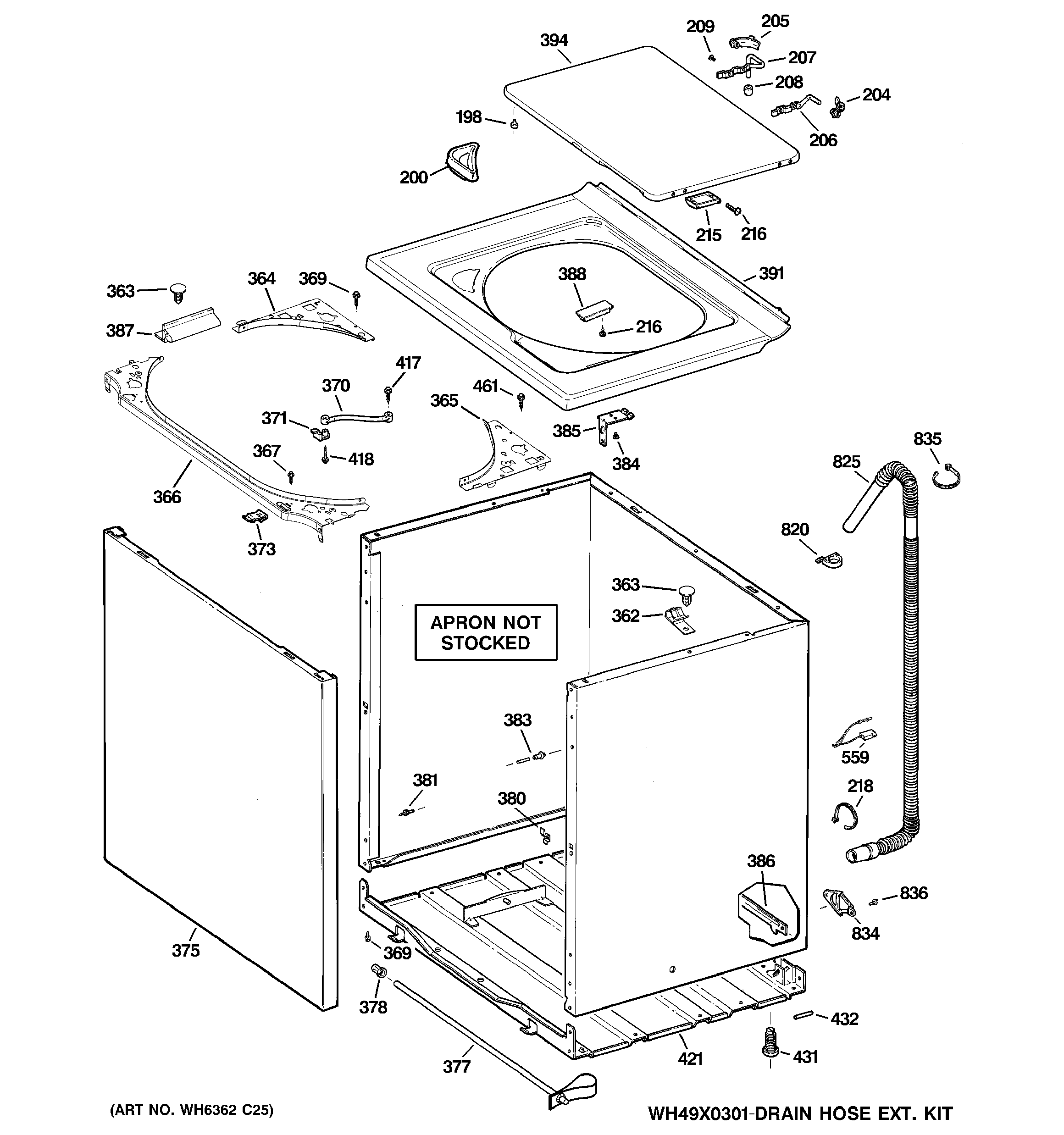

Washer is 1.5 yrs old. Is rarely used in vacation home. Maybe 30 times. The machine wont agitate aggressively. all other functions appear operational.
What could this be?

GE washers do not typically agitate very hard, at least in my opinion. You can check the belt tension, and you can verify that the motor is operating in both low and high by testing different cycles. Like normal vs. delicates, you should notice a lage difference between the speeds, in those two cycles. Does it seem to spin ok? By this I mean does it seem to wring out most of the clothes, when it does a spin cycle?

to defeat the lid switch you can use a magnet, lay it on the sensor, and it should wash and spin. Please be careful while you have the lid open.Posted Image
part 388 in the above break down.

Great. How is the front panel supposed to be removed? I thought the top popped out first then the bottom. That's not how it went. The bottom came out and the top will not come out. It sort of hinges upward which Im sure is wrong but it allowed me to look inside. Now I cant get the bottom back on the hook. I may have bent the top clips ?????

lol its all good, to remove the front pannel, there are 2 clips at the top, you'll need a putty knife or a flat head screw driver to pry up on the clips at the top. If you look they are pn 373 in the break down above. When you go to put it back together put the front on the bottom clips first then, just push it into place.
