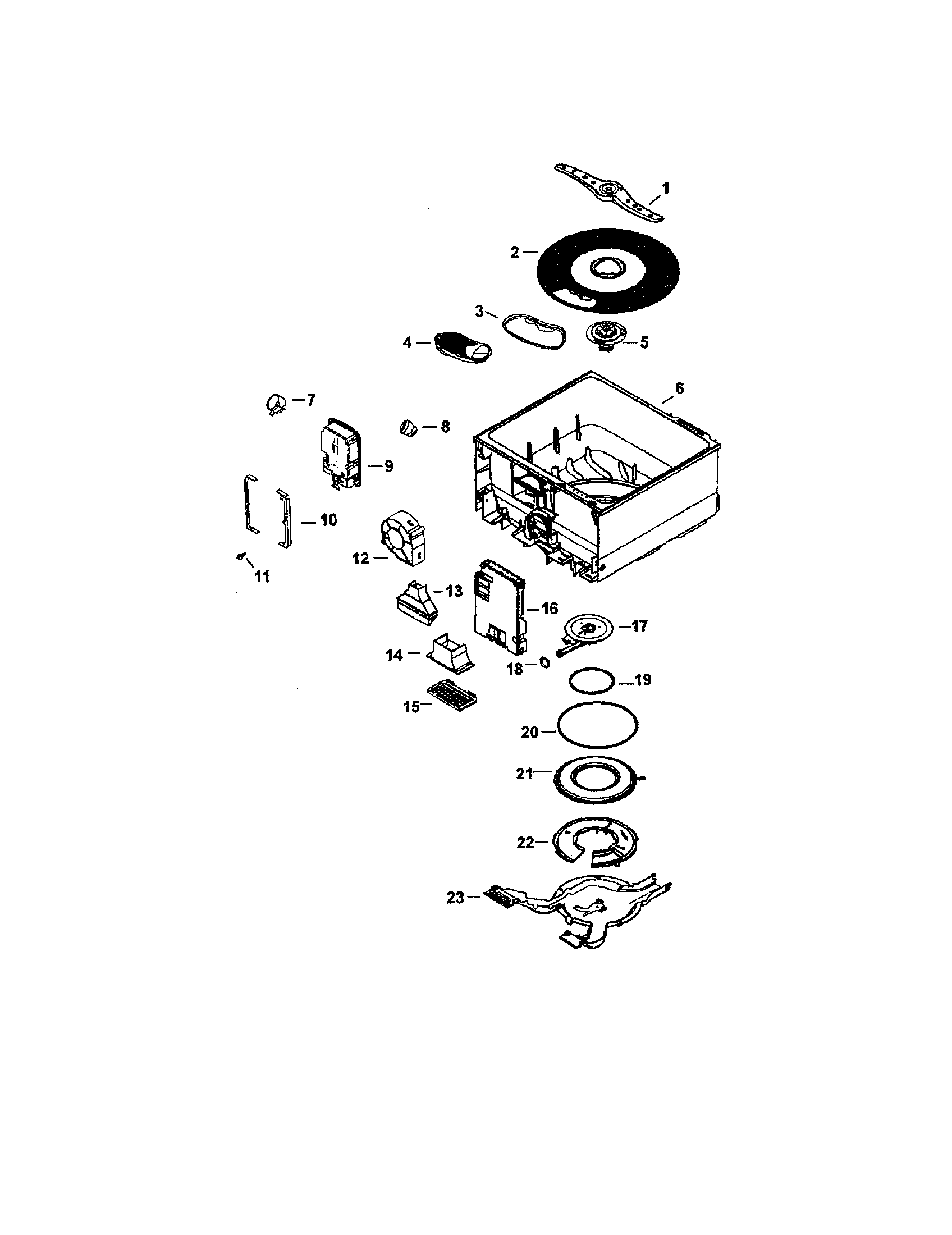

Ok, I have tried everything. What am I missing. We have just the top drawer installed, no bottom. Replaced a cracked drain hose a year ago. 6 months ago the dishwasher would leave a cup to a cup and a half of water in the bottom. After a couple weeks it starts nasty black mold to growing everywhere. I blew out the drain hose, replaced the rotor, and replaced the flap valve in the drain hose. The dishwasher still leaves a cup and a half of water in the bottom. What is interesting is that I can manually activate the drain function P2 in diagnostic mode and drain 90% of the leftover water out. There is still a small puddle in the food debris area, but only about 2-4 tablespoons. Is there supposed to be any water whatsoever left in the food trap area? Any help is greatly appreciated.

does your dishwasher drain into an airgap? or straight to the disposal?
Yes there should be a small ammount of water in the sump area all the time, to prevent the seals from drying out.

My DD603 has this much water left in the filter sump as matter of normal course ... just enough water to fill the sump area, not up into the tub-proper. The spoon is for visual reference, dunno if it helps much. I'd estimate about 8 oz / 1 cup. If that's what you have, then there's no problem. A brief drain is always run at the start of a cycle. My unit is 8+ years old, haven't yet had any trouble or repairs on it.
