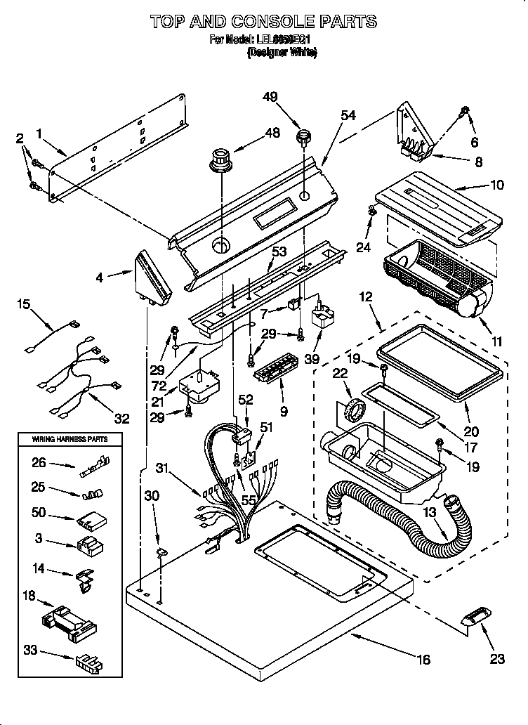

A customer has a WP clothes dryer M#LEL8858EQ1. She complained of her basket (http://www.repaircli.../3399994/527786) always being empty, BUT having no lint backing out into the laundry room. I vacuumed a lot of lint from the plenum, and changed the belt (original problem). What's the deal with this odd-duck lint system?

That's a different duck for sure. I understand how it works by looking at schematic but would like to dissect a real one. I'm good at taking things apart and figurin em out...not so good at putting it back together. (Let me see ...the hip bone is connected to the neck bone and the neck bone is connected to the arm bone...sounds'bout right ...got a few bones left over.. :kopkrab: oh well)

for anyone's reference :kopkrab:

That's Whirlpool's Easy Clean 100TM lint filter (which is reminiscent of a similar Kenmore lint collection system way back in the late 1950s / early 1960s which used a disposable collection bag). The basket is supposed to hold up to 100 loads of lint before cleaning is needed.

It was an awful design, and them things would plug up something fierce. There is a diverer down close to the end of the exhaust that will collect lint and start the process of plugging up the whole machine. I've only seen a few of these "gems".
