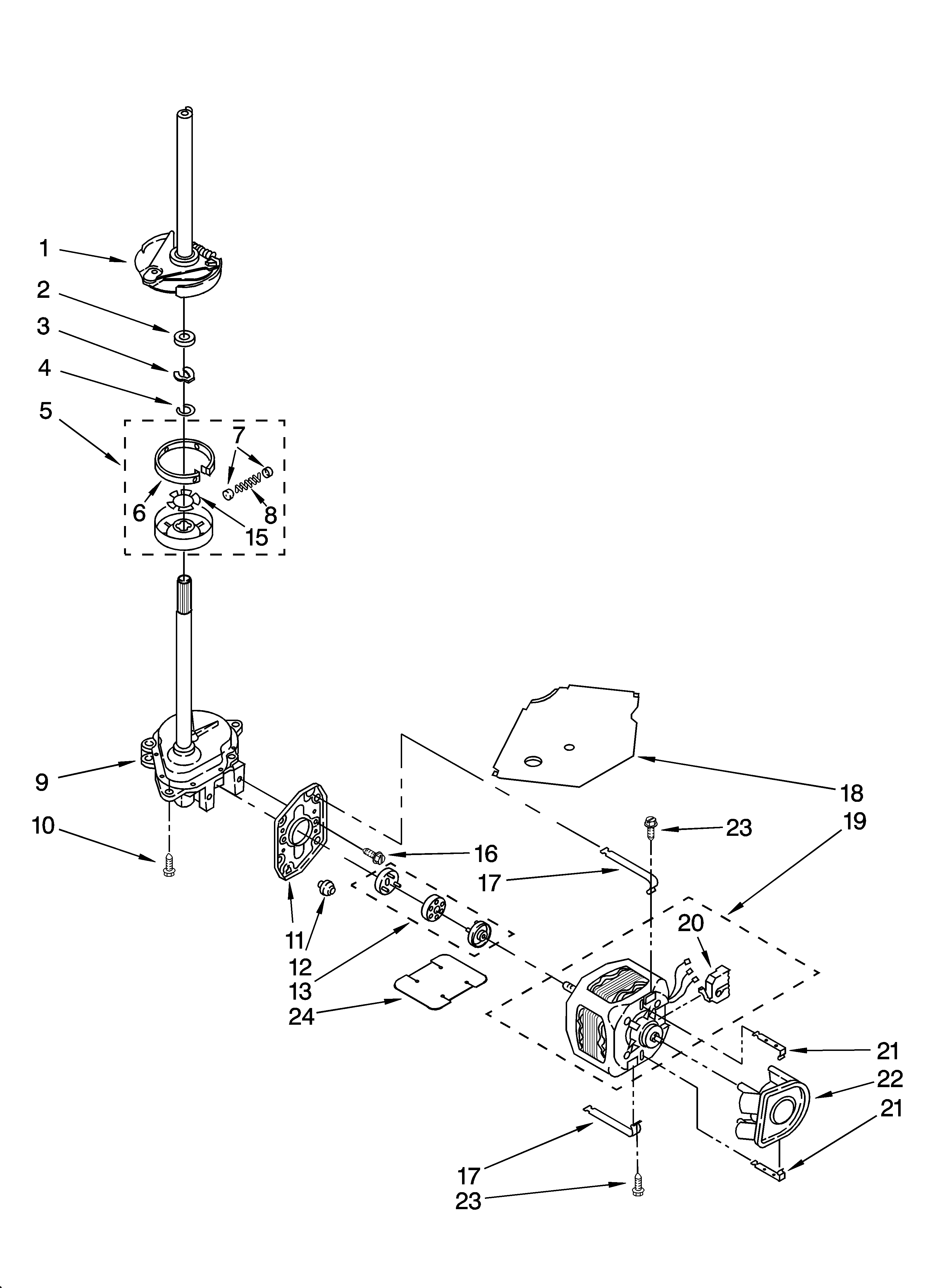

This Whirlpool Gold Ultimtate Care II washer doesn't complete its spin cycle, spins slowly leaving clothes wet in the machine. When the problem occured about 6 months ago, a technician repalced the belt but the problem came back now. I have had this machine for about 3 years now. Thanks.

My guess would be to start with the motor coupling, be sure that it is not broken or stripped. It looks like part # 13 below, if that looks and feels ok, there are some other things to check. Posted Image

When you have your head under the hood , another thing to check, is there oil on your clutch ?? to check that , is there a ring of oil/water about 12 inches from the floor on the inside of the cabinet??? If oil, it could be a leak at the top seal of the gearbox...if water, it could be a leak at the center post seals or the spin tube/brake assy. seals....
