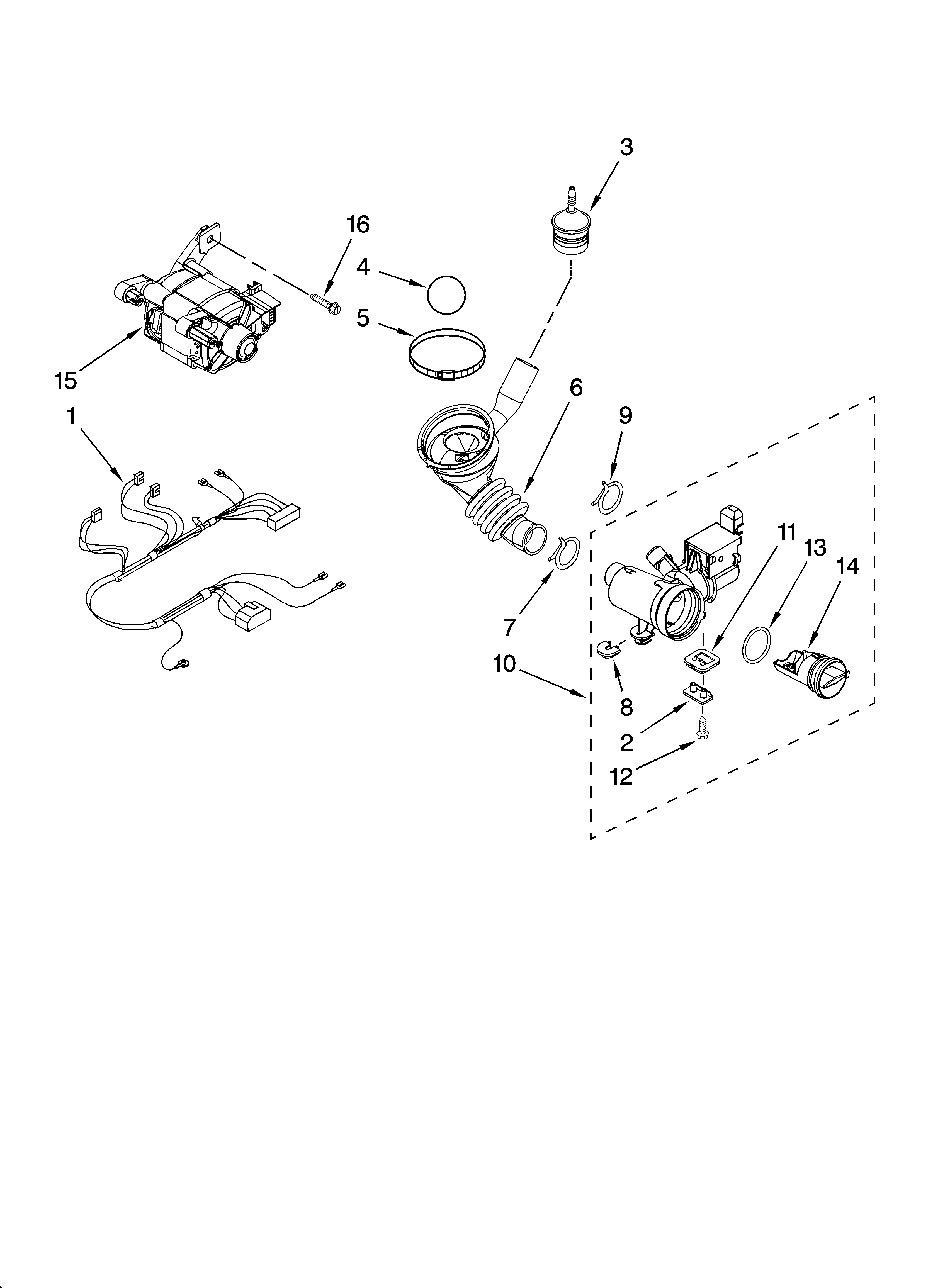

How do I change the wire harness on a whirlpool washer model #WFW8300SW03

I hate to say this, but 1 wire connector at a time. What part of the harness is damaged?

The washer would throw a f01 code when it got to the spin cycle. I replaced the ccu and then it blew the new ccu immediately upon entering the spin cycle so I'm thinking there is a ground to short somewhere. what do you think?

worth a shot, to double check the motor, and motor control board.
W10197864 is that the part for the CCU?
What I would say is that it looks like it has 1 harness, and its looking like it comes from the bottom, up, it shouldn't be to hard to replace.Posted Image

OR if you could "test" connect it without routing it, nor removing the "old" harness . . .
