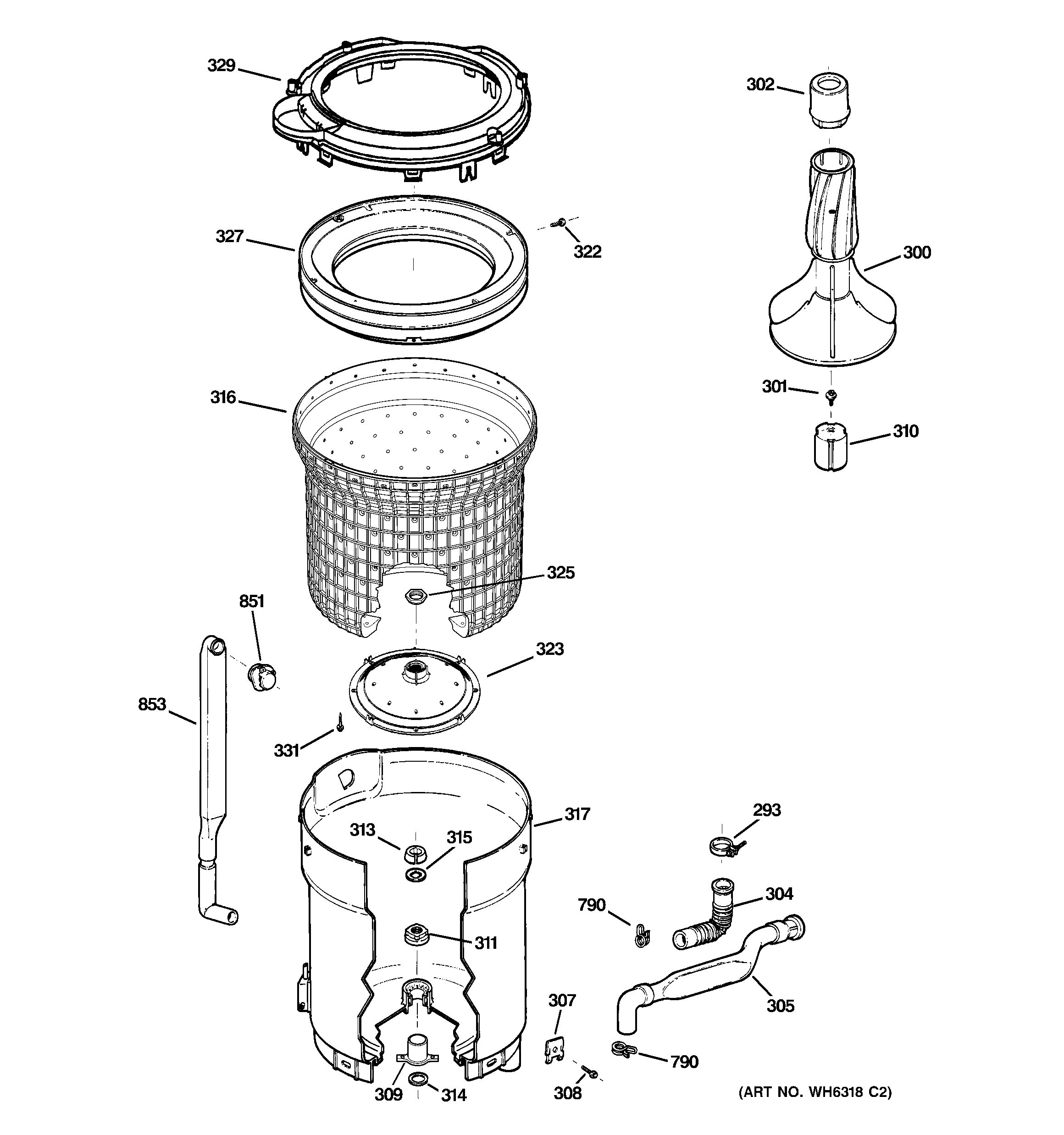

having problems removing the bearing adaptor after removing the bolt

What Bearing?, What Bolt? - Do you mean the Split Ring and Tubnut?

Which part below has you stumped?Posted Image

I removed the agitator and retaining bolt for the coupling but cannot get the coupling off in order to get to the bearing

You can try a prybar ...wonderbar works best or as a last resort, split it with a screwdriver and get a new one...
