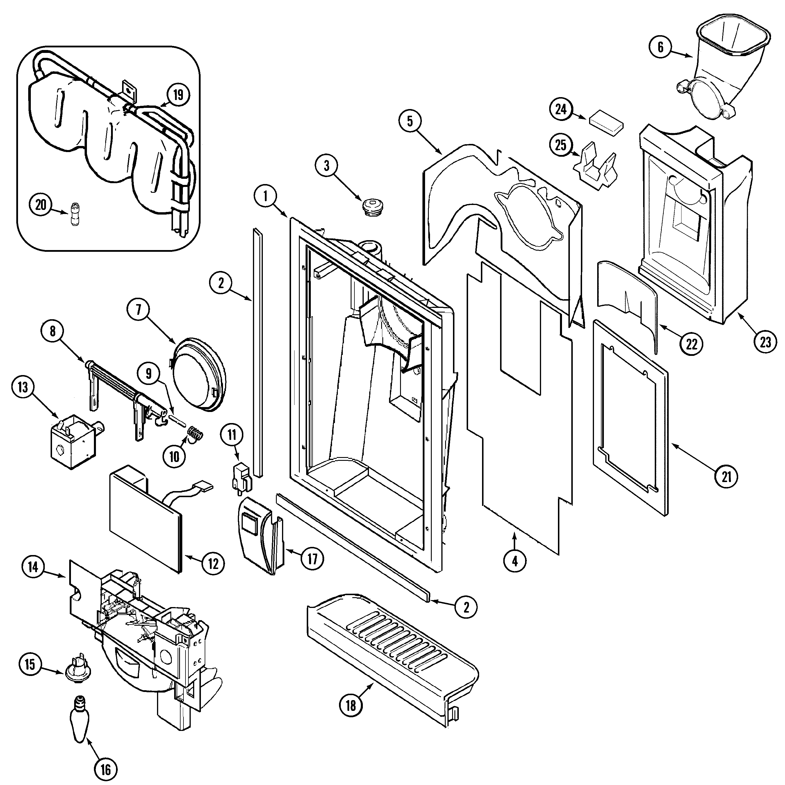

The chute door seems a little loose, ice is dispensed fine but there is a loud buzzing until the chute door is pushed shut. I am assuming I need the dispnser solenoid and door kit but I have no idea how to replace same.

More than likely actuator/solenoid part 13 on the diagram. It comes in this door repair kit http://www.repaircli...12001991/940492
remove drip tray and then remove screws....here's some video help

Thank you will purchase the kit and give it a try
