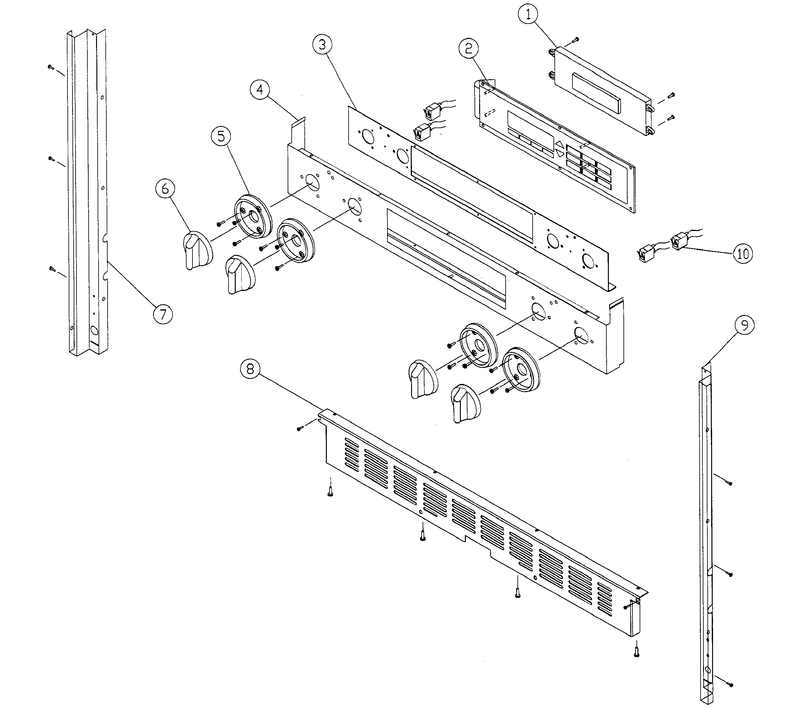

Lastly, off topic from the board failure. Sadly, I previously knocked the blue led lights off of their perch on the backside of the stainless steel front. So I'm missing something plastic (part of the white plastic housing that holds the wires and the bulb) that will allow me to reinstall them so they show up on the outside of the stove. So as you can see in the photo, I'm missing a light. How do I fix this --- what part do I need?

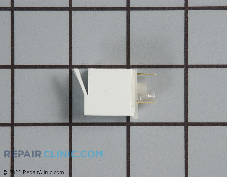

Samuria -- do you sell the blue lights that indicate the burner is on? I did not see that on your Parts site. I did buy the Relay Circuit Board this morning.

... do you sell the blue lights
maybe G8P ...
http://www.repaircli...?R=154&N=755763

RegUS, I'm pretty sure the actual lamp isn't what is needed. That would still be OK and dropped down inside the control area somewhere.
He needs the blue light lens that pushes thru the front of the console then the actual lamp that you have referenced slides onto the portion of the lens that sticks thru the console holding the lens and lamp assembly all solidly in place.
William Burk (Willie)
Eureka, CA 95501
#19 RegUS_PatOff
  • 30,283 posts
Posted 08 December 2011 - 08:27 AM
#10 82086 Indicator Light, Blue :kopkrab:
Lens may be the item included in the parts picture ?

I purchased the part referenced by RegUS, and hopefully it does come with the blue lense, but because Budget is right, that's what I broke. The light part was $7 so no big deal. Thanks guys!
