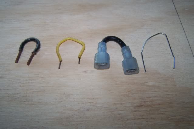

You will need to make a 'jumper'..
The  first three are ones I use, the fourth one is used by someone that should NOT  be any where near electrical work................... DO NOT be that person, use an insulated 'jumper'.......  Okey Dokey ....

#9 jjrree1
jjrree1
    Unsui
  • 4 posts
  • Flavorite Brew:Water with Lime
Posted 19 December 2011 - 07:22 PM
Ok, I made the jumper and ran 6 loads through the washer.  Obviously I did that many loads because nothing unusual was happening. I sat through the 1st 2, and all went well, I did get a hint of the burning smell during the agitate cycle rite at the beginning, but after that nothing.  Pretty much watched it most of the day. I was overloading  the washer before and I did not do that again. I am thinking I heated up the clutch.  I even hooked up a ohm meter using a patch cord of sorts and watched that, ohm never got over 10, most of the time stayed at 7 for all cycles.
