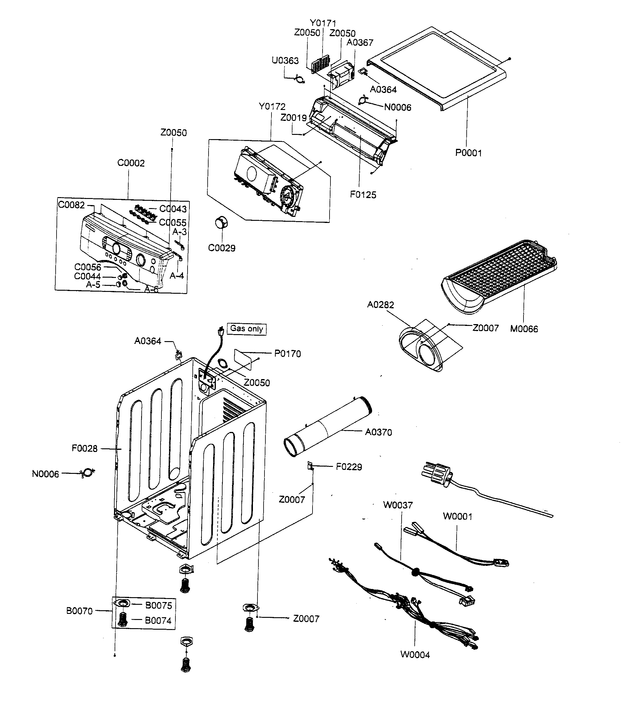

Symptoms: Dryer Shuts off after about 20-30 minutes. Display is totally off. If you open door, light comes on inside. After you wait maybe 10-15 minutes the display comes back on and you can start again where it left off.
If you change the dry level down some it runs longer. Once in a while we will get thru a full cycle without it shutting off.
On Air fluff, never shuts off.
Things I have tried:
1. Clean out the inside.
2. Check for obstructions.
3. Run without exhaust hooked up. Same Results.
4. Great flow out back.
5. Replace control panel (main board display). No difference.
To me it seems like it gets hot, then disables display and shuts down. When it cools down, it then comes on.

<<<Replace control panel (main board display). No difference.>>>
There are 2 boards on this dryer---a MAIN BOARD & a DISPLAY BOARD.
Very odd symptoms :)
Sounds like a failed MAIN BOARD---is this the part that you replaced?

Thanks, I didnt even catch that part. its mounted clear up on top and most part diagrams dont show. it. I bet thats it. I replaced the display board, not the main board. I will try that and post back. It may take a few days to get it.

Very high problability that the MAIN BOARD is at fault----since the DISPLAY BOARD does not run/operate the cycles.
The primary function of the DISPLAY BOARD to receive user input (cycle selection & options) and then when the START button is pushed---all the data (selections) are sent to the MAIN BOARD. Cycle begins.

Y0171 Main Power Control Board
(top of diagram)
