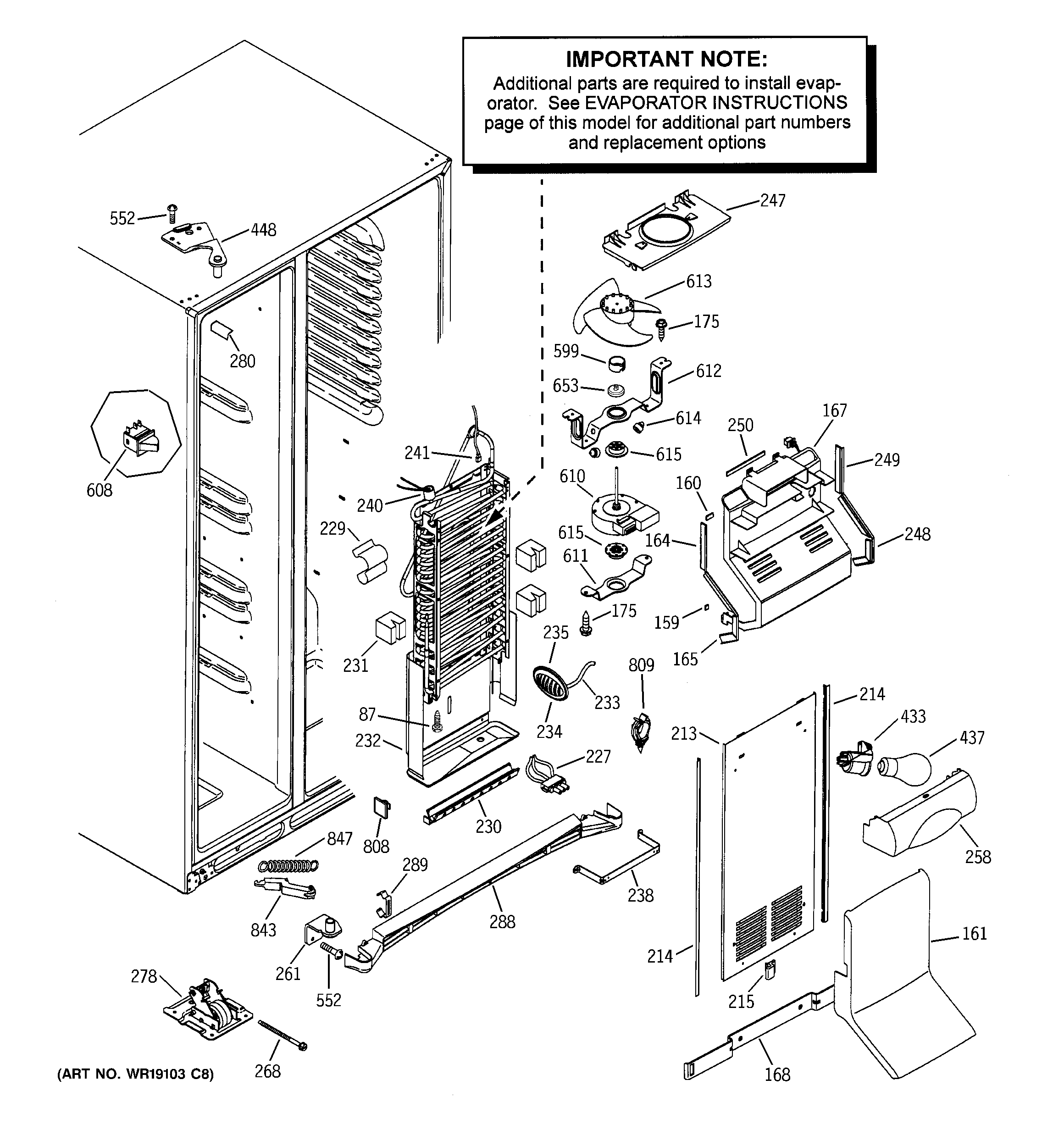

My Freezer will not get below 20 degrees. I checked the evaporator in the back of my freezer, and it is completely covered with frost. What is my next step

... completely covered with frost.
pictures ?
Does the Evaporator Fan run OK ?
It may be a bad Defrost Heater
or a bad Defrost Terminator (switch)
OR a bad MotherBoard.
depending on the first (2) characters of your serial number, there may be a recall on the MotherBoard

I work at a computer company, so I will have someone get me a meter and show me how to use it. Do you have a diagram that shows me where these two parts are. I assume the theromstat is on the evaporator somewhere, but I see a couple things on the evaporator that look like they may be a thermostat. Where is the Defrost heater

Evaporator inside the Freezer
Defrost Thermostat # 240
Defrost Heater somewhere ... maybe near the bottom
